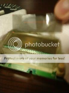

    A big thank you to you. finally got down to getting it done. got the polarizer from the link you'd provided as well. the display reads so well once again. Im on a VTECII. Replacing the polarizer on the face was slightly difficult cos the needle didnt allow me to remove the face of the meter (or rather i didnt know how to remove it). but it was still possible. just slightly tedious. Also, the meter lights shine much better with the traditional bulbs. the LED ones dont light the meter up evenly and more importantly, didnt read the LCD dislplay properly. Just my 2c!
    thanks again!
    Quote Originally Posted by AllHailKingHenry View Post
    Hey all, just wanted to share with everyone how I DIY-ed my meter's burnt/melted LCD screen that some of us are having problems with on our S4s. Do note that the orange line that goes in between the clock and odometer will be gone after the fix as it is printed directly on the old polarizer. This is not intended to be a tutorial or guide, but just a general show and tell. Try practising on an old calculator if you're not confident before proceeding onto your S4's meter. Proceed at your own risk!
    Things you'll need
    To repair the LCD screen, you would need a linear LCD polarizer (available online here), a sharp pen knife and some sort cleaning solution that can remove the adhesive residue left behind by the old polarizer (I used something called Goof Off, bought from Homefix). Do make sure that your chosen cleaning solution is safe for use on glass. To remove the meter itself, I used normal home tools such as spanners, wrench, etc.
    Total spent on supplies = S$27
    Now on to the fixing:
    Remove the meter from the bike and dismantle the meter until you are left with the PCB board.
    Then, use the penknife to remove the old polarizer. Be gentle and take your time, do not rush. Apply your chosen cleaning solution (put paper towels all around the LCD screen so that none of the cleaning solution gets onto the PCB board) onto the glass substrate and use the penknife to scrape the old adhesive off. Again, be gentle and take your time. The surface has to be cleaned thoroughly before applying the new polarizer (Very important).
    After cleaning.
    After cleaning the glass substrate, take your new polarizer and place it on the glass substrate to check the orientation of the polarizer. If the the LCD screen is all black (colours will be inverted, text will be white while background will be black), rotate the polarizer 90 degrees (direction does not matter), the LCD screen should turn to normal colour. You can cut your new polarizer to size, with the same orientation, using a pair of scissors and apply it onto the glass substrate by removing the adhesive backing on the back of the polarizer. Please orientate the polarizer correctly before applying on the glass substrate Do not forget to remove the protective film on the front of the polarizer before re-assembling the meter. After reassembling the meter, this is what you get;
    Well, that's it. If anyone has anything to add, please do so. I apologise for the terrible/ lack of pictures as I do not have a digital camera with me. Also sorry for the bad English. Thanks!
