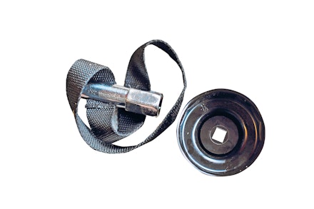

    Step 3:
    A strap wrench (left) and a cup wrench for removing an oil filter
    ©PHOTO: BAUER MEDIA
    Now you need to think about how you are going to remove the old oil filter. There are two main ways to do this – with a cup-style filter wrench that fits the flats on the filter and drives from a socket handle or a strap (or chain) wrench that tightens onto the filter body as you rotate it to loosen the filter. The choice comes down to personal preference or what’s available for your bike.

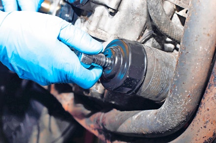

    The wrench fits over the end of the filter housing and is very easy to use – you locate it like a large socket and use a ratchet or handle to undo it until it is hand tight and you can remove it. Be careful of the oil spill as you do so and lay plenty of rags or paper towels under where it locates, particularly if it is angled downwards as you work on it.

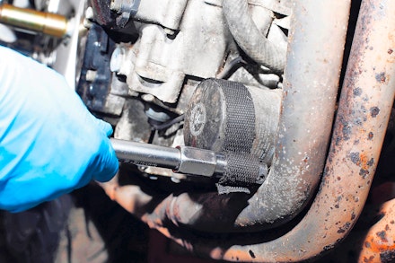

    A strap wrench tightens itself on as you rotate it until it grips the filter housing and begins to rotate it until you can again, remove it by hand. These can be useful if access is tight or you can’t get a wrench over the top of the filter and get a handle to it directly.

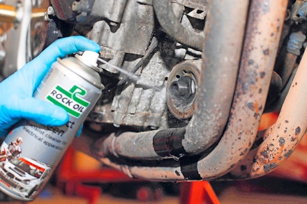

    Step 6:
    Cleaning the oil filter mounting surface
    ©PHOTO: BAUER MEDIA

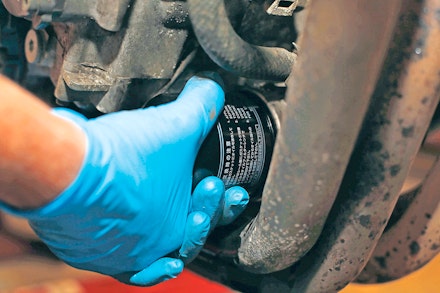

    Once the filter is off the engine, remove it and when convenient, drain its contents into the drain pan that now contains the contents of the engine. Use some carburettor cleaner or degreaser to clean the mounting face ready for the new filter.

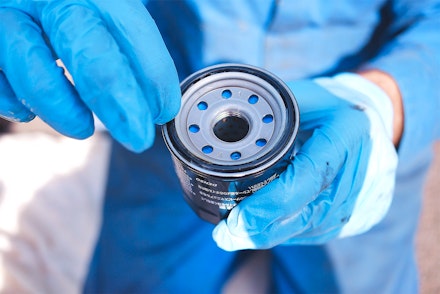

    Before fitting the new filter, smear a thin layer of oil around the rubber ‘O’ ring - this will help it seal properly. If the filter is mounted directly from the bottom of the engine, you can fill it with new oil to ‘prime’ it. If it isn’t then fit it empty and it will fill when you first run the engine.

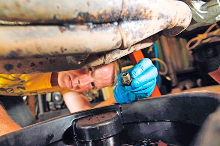

    Step 9:
    Fitting a new sump plug washer
    ©PHOTO: BAUER MEDIA

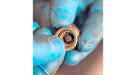

    Before you refit the drain plug so you can refill the engine, have a look at it to see whether there is evidence of worrying wear – metal particles, for example. If not, give it a clean and remove the old washer, replacing it with a new one.

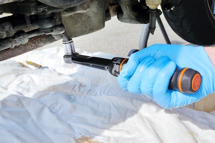

    Step 10:
    Re-fitting a motorcycle sump plug
    ©PHOTO: BAUER MEDIA
    Now refit the drain plug and tighten it to the relevant torque figure, as per the owner’s or workshop manual.

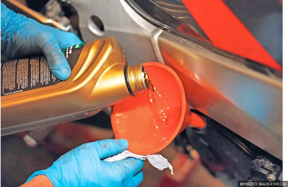

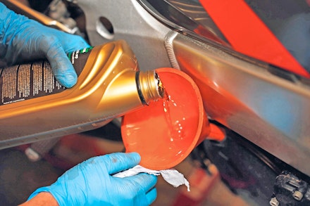

    Step 11:
    Pouring fresh engine oil into a motorcycle using a funnel
    ©PHOTO: BAUER MEDIA
    It’s now time to refill the engine with lovely clean oil. Using a funnel – to actually get it into the engine – or a measuring jug, either apply a measured quantity, taking into account any you may have already added to the filter before fitting it or fill to a level in the sight glass or on the dipstick, depending on your bike. Make sure the bike is upright and level when checking oil levels.
