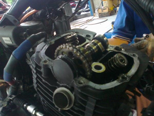

Just a question. Is it true that the pulsar top head always leaks? . Because even when i bought my bike. Its leaking.
I guess, when the bike is on stock sprocket setup and ridden at highway speeds the RPM is just way too high(~8k+) and the pressure created causes the glued seals near the cam cover area, to give away. By design the pulsar wasnt meant to be ridden at such high rpms continuously anyways.
Not sure how frequently it happens, but would have happened in most pulsars atleast once in it lifetime.
if revhappy theory is right .. you just need to spend $35 sgd only once in a life time to rectify that problem .. cost inclusive labour and 3 parts need to change ... camshaft cap and 2 pcs O rings for tappet caps .... :)
the positive side when you send to fix that problem... you can see the condition inside of your top engine .. kekekekke :)
