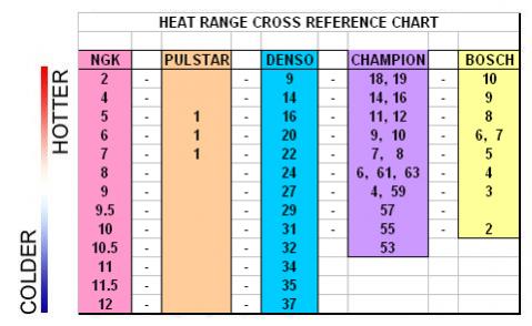

P200NS Stock Spark Plugs
Secondary Spark plug (2 nos) : RG-6HCC (LH 'A' + RH 'B'),
Primary (1no) : BOSCH - VR5NE (Centre 'C')
Intresting to take note ...
It's Primary plug using hotter plug than the our standard current primary ... hmmm
so wats the option heat range for NGK as alternative ? .... check here
cheers !!
