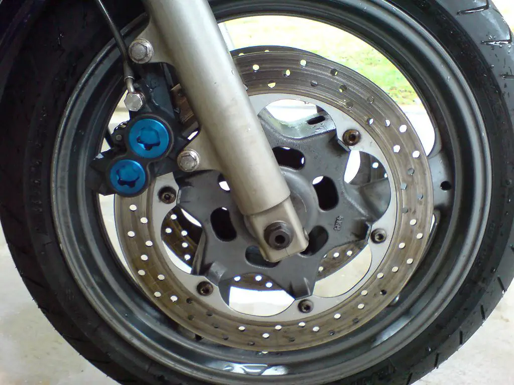

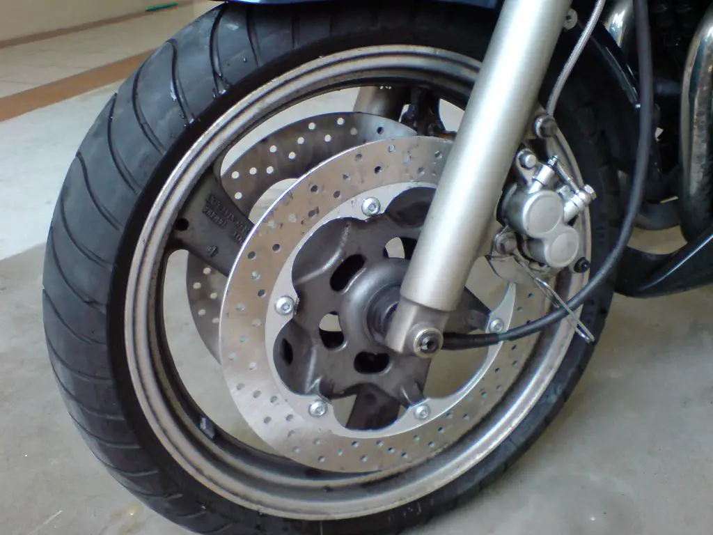

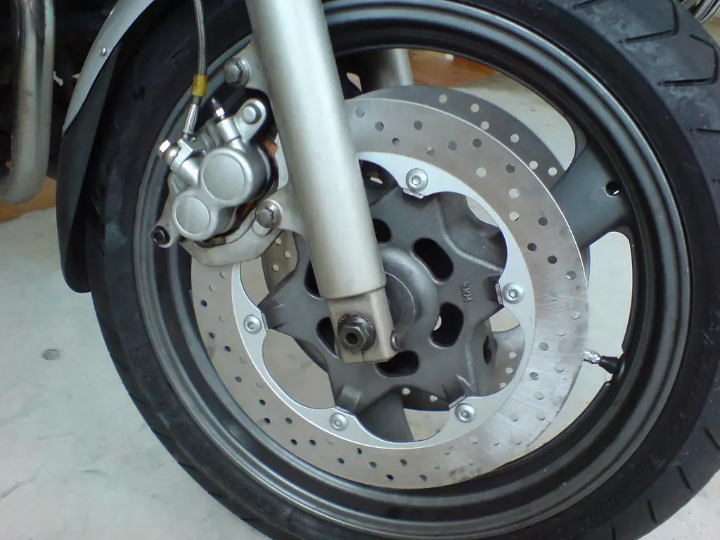

Changed front brake disc, front brake pads, front wheel bearing, bearing oil seal, front brake caliper pistons, piston seals and flush brake fluid.
Braking effect has improved.
After changing the bearings, front wheel/handle no more shaking while travelling at 50km/h with both hands slightly away from the handle grips.
:cheer:
:cheer:
