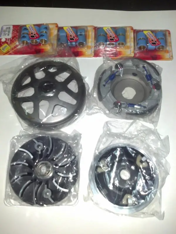

[ATTACH=CONFIG]232569[/ATTACH]
if u guys remember,I am attempting to replace my variator and
clutch with aftermarket ones.
Not waiting for the spring anymore,no time.
It has somewhat hit a road block, couldnt get the variator nut off.
Transmission cover no problem in opening,8 short screws,1 long
screw and another screw which screws
the airbox together with the transmission cover.
Used an air impact wrench(taiwan) to loosen the clutch nut, no
problems but when i tried to loosen the variator nut it
wouldnt move! tried and tried sheesh.....maybe from factory
they whack strongest setting.
Forgive me for not taking pics of the original clutch bell and
clutch, visually not very nice with crude workmanship, mass
produced items what do I expect.
my next step will be to go for my servicing and ask them to
change for me the items.
Will it void my warranty? or should I go to another workshop
for that?
Thanks Guys
