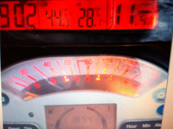

Temp goes up to 3bars, slowly but surely. Then it will eventually hit 4bars. On expressway riding. 90km/H RMP 7-8K constant.
Fan turns on from 2bars - 3bars. Funny thing when it reach 4bars, the fan CUT OFF.
never to on again. until bike cools down. then the whole thing repeats itself.

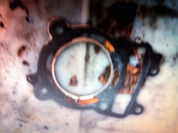

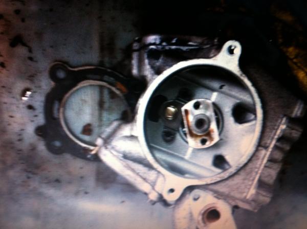

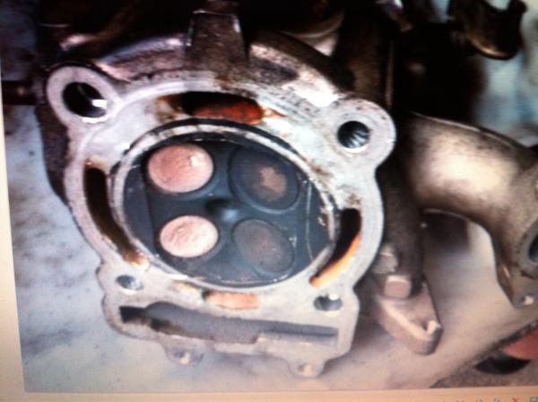

As I said earlier thread, it caused by a blown gasket like my case and a small pin hole near the liner that heat up the coolant in the glands, that envelop the block, I spent tons of time and money, changing the thermostat, full flush coolant, full flush engine oil, change coolant tubes, but no avail,
Sure as found the naughty cat as the blown gasket and a pinhole leak that leaked hot exhaust air and extra boil the coolant and going thermostat to register 3 bar to four bar and steam coming off
Oh I spend $250- a second hand block, top overhaul , grind the valves, valve setting, new piston rings and top gasket...that does not include the other earlier cost for mumbo jumbo before diagnose this naughty cat lolIMG_1729.jpgIMG_1728.jpgIMG_1730.jpgIMG_1731.jpg
Oh I spend $250- a second hand block, top overhaul , grind the valves, valve setting, new piston rings and top gasket...that does not include the other earlier cost for mumbo jumbo before diagnose this naughty cat lol[ATTACH=CONFIG]233310[/ATTACH][ATTACH=CONFIG]233311[/ATTACH][ATTACH=CONFIG]233312[/ATTACH][ATTACH=CONFIG]233313[/ATTACH]

Did you get oil in the coolant?
Coolant in the oil? (aka chocolate milk colour)
White smoke?
Sweet burning smell from the exhaust? (burning anti freeze)
A worn gasket will give at least 1 of these signs.
