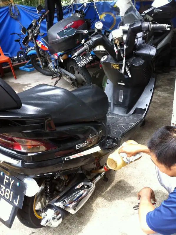

Bro, I got a honest shop if u want, he repair my 4 yes 4 scooters and I trust him a lot, these scooters are Suzuki Epicuro 150, Sym Joyride 200, Gilera VXR200 and latest is Yamaha Majesty 250. Only the Suzuki was sold to a friend cos he liked it too much and I cant bear the loss. So I still had 3 more scooters to play around and my Sym was the one I told earlier thread, where I had a severe case of coolant overheat to 4 bars, that there was a blown gasket and a pinhole sized hole that leaked heat and extraboil the coolant to 4 bars.
Name is Ah Peng 91462863
Location is Woodlands Road, next to Stagmont Ring Road (ex Caltex station)
[ATTACH=CONFIG]233641[/ATTACH] [ATTACH=CONFIG]233648[/ATTACH] [ATTACH=CONFIG]233649[/ATTACH] [ATTACH=CONFIG]233650[/ATTACH]
Hi bro mdjzz, thanks for ur recommendation, will call him later & ask to check my GTS, hope nothing serious..
Hi deepblur, will call u up for the installation of the bypass switch for fan. For now need to go to the shop
that bro mdjzz recommend first.
