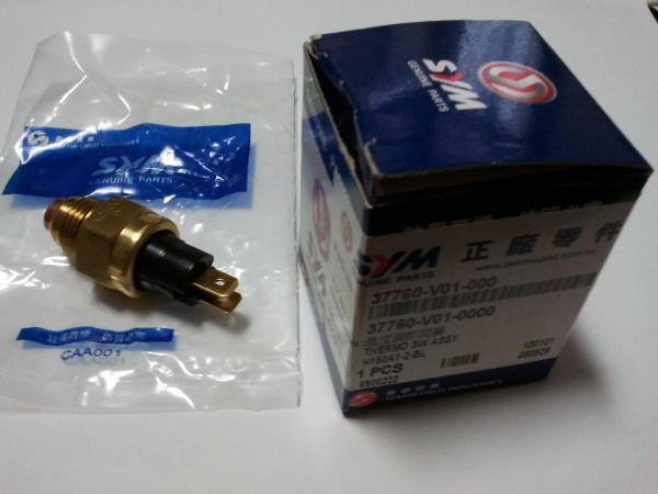

If you are servicing your scooter, you can ask the mach to install the by-pass switch for you while the cover is taken out, just a switch parallel to the thermostat, save all the trouble to take out the covers again later just for the switch.
I am putting on an electronic thermo controller to further protect the radiator and the engine, the default temp for SYM to switch on the fan is 100 deg C, kind of crazy as the coolant is almost boil, I am going to activate the fan at 60~70 deg C as recommended by most expert, this will protect the valves also to prevent the high temp damage the valves.
The original SYM termo-switch is around $30, don't go the Mah, your head will drop.
Hi bro mdjzz, thanks for ur recommendation, will call him later & ask to check my GTS, hope nothing serious..
Hi deepblur, will call u up for the installation of the bypass switch for fan. For now need to go to the shop
that bro mdjzz recommend first.
