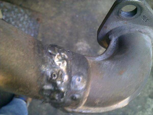

Problem is solved, guys. I went back to the workshop and the very senior guy there spotted a hole on my exhaust pipe. It's the part that is under my bike at the belly part. Apparently, the previous owner had got it welded before. The loud bangs must have came from this hole.

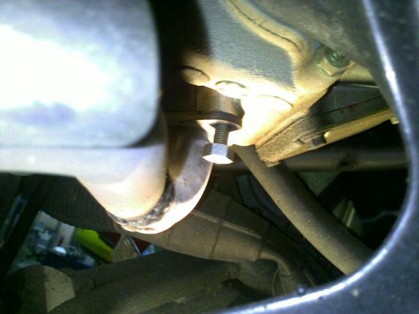

The thought of my previous visit to change my rear tyre immediately came to my mind. I recalled the "runner", who were asked to change my tyre, having tried to unscrew a nut below my bike's belly. As my bike wasn't placed on a ramp, he had to bend a little to try to have a good view of the screw. He didn't really get a good view, from what I recalled and he was turning the spanner without looking at it. He failed a few times when his spanner had slipped. Gosh! I've got a hunch that his spanner must have hit the pipe and caused a hole. Why this assumption? Cuz right after I've drove out of the garage, the bang bangs came soon after a few streets down. :dot:
Anyway, the guy removed my exhaust pipe so there's only the thin first half of the pipe with the thicker end rotated out and left there and we went to another workshop couple of shops down. They did some dripping ("di1" in mandarin) of some metal on the hole to cover it up. Viola! The bang's are gone but a new hole was found in my wallet. :dozed: damage is $25 ($15 for the dripping and $10 for the workshop's svc charge). Thing is, if my assumption that their "runner" had created that hole is true, then it's really a damage to my wallet and it's not worth it. Anyway, thank God it's not $100 over.

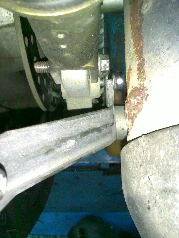

Photographs attached:
1st photo - shows the bolt that's on the belly of my bike (don't you think that a spanner that had slipped from trying to remove this bolt can hit a hole on the pipe? quite obviously, the answer is "yes, it can!" :( )
2nd photo - the bolt that holds my mud guard
3rd photo - the welded part of the pipe after welding done

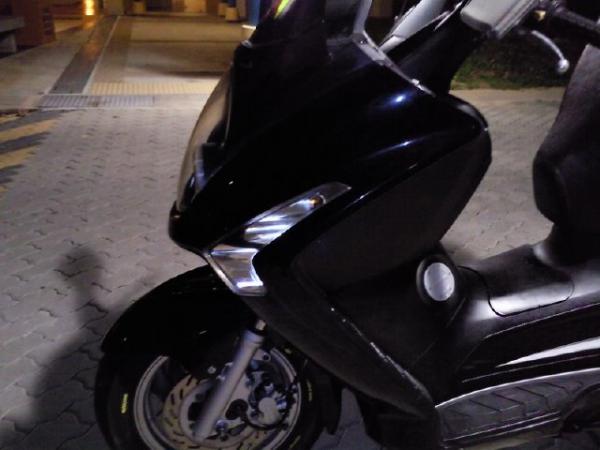

http://i145.photobucket.com/albums/r208/zyrofillica/IMG_0039.jpg
comments? just wax and wash. not sure if the colour combo/stickers go well to potray a younger image lol~
