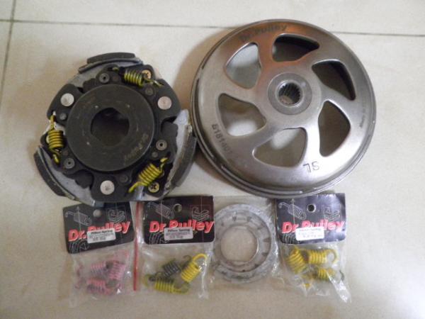

Hi all, selling my Dr Pullery clutch set for a knockout price of $300 due to not install it as i sold my bike. Brought at taihin at $550 so my loss is ur gain, interested pls sms me @98214979 to deal at balam rd.

Hi all, selling my Dr Pullery clutch set for a knockout price of $200 due to not install it as i sold my bike. Brought at taihin at $550 so my loss is ur gain, interested pls sms me @98214979 to deal at balam rd.

What do these do? Does it make the GTS faster, more stable, better pick-up etc? Sorry for asking as I have no idea about all this. I just bought a GTS. Currently, the GTS is only 4 days old and my finding is that while moving off, I find the scoot macam dragging but once on higher gear, its smooth. Overtaking can also be a challenge.
Dr Pulley is a company in Taiwan that manufacture after market performance parts for scooters.
They are famous for their revolutionary flat slider roller that is not round. Giving better pick up and
lowers cruising rpm depending on the weight of the roller used.
The next thing besides the roller and Variator is the clutch. Dr pulley has come up with a better
clutch to replace the original clutch so it seems. How good I don't know and haven't tried any. But
Flat slide roller are best for me. More lasting and better performance.
Dr Pulley name their clutch Hit clutch which provides better engagement than original. Maybe
Lessen or eliminate vibration during biting point. The hit clutch system should come with the clutch
bell or it's also call clutch housing, clutch drum...etc
There should be review on the net on this item and on YouTube too. Just watch it on YouTube yesterday with a hit clutch on Kymco MyRoad700.
Confirmed the part number if you are getting with the Dr Pulley website which is also known as
Union something, can't remember :D
Then again, the clutch require fixing also. I suggest you buy the flat slider roller to change it as a set
With the clutch cuz 1 time labor charge is better than 2.
Since your scoot is still new, I suggest you get use to the power or rather get use to no power say for a year or so than fix it then you will know how good or bad the product is :D
What do these do?
-It makes more positive engagement (what ever that means? ha ha) less slippage, less vibration?
-Nope it doesn't make it faster. More stable, yes in engagement of the clutch and biting point. ? For pick up maybe, cuz less slippage and more friction thus you take off faster but might bogged down engine which may not be the case cause we a dealing with scooters here. Like releasing clutch too fast on a motocycles and the rpm not high enough the bike will choked, something like that in my own theory.
