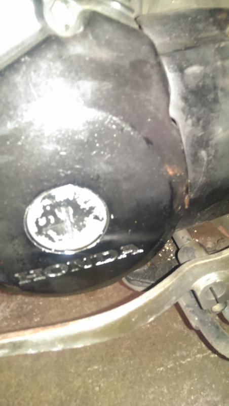

Need your professional help. Saw trace of oil coming out at the picture attached. But didnt find any trace of any oil leak on the ground as I park overnight. Any issue?

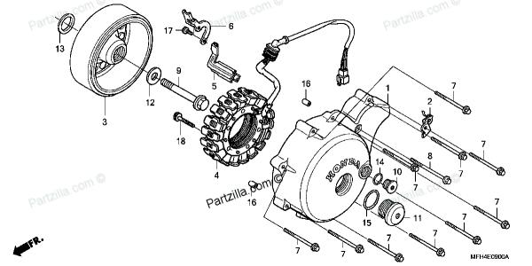

No issue.
There should be an o-ring behind the cap [part #15]
If you know the size or take the worn o-ring/cap to the shop to match the size, it will cost you 20 cents to replace and stop the oil seeping :thirsty:
