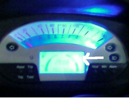

Hi guys, i recently got hold of some high powered T10 LEDs (6 very very very small LEDs in 1, super duper bright). these T10 LEDs can be used as pole lights as well as meter lights. These LEDs come in 4 colors:
1. White
2. Blue
3. Red
4. yellow.
For non digital pulsars, the meter lights u also can use these T10 LEDs, but the effect will not be as good as digital pulsars becoz the meter itself is sort of "blocked". but for the fuel gauge, yes, effect is very nice!
For digital pulsars, the meter lights u can use these T10 LEDs. the effect is superb!!!!!!!!!!!!!!!!!!!!!!!!!!!!!!!!!!! u can trust me on that!
