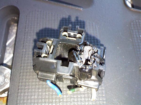

My socket melted probably due to the high heat range of the bulb I use.
Does anyone have this experience before?
I went to authorised spare part shop. They only sell this with the wire harness which will cost alot. Anyone knows where can I buy just the socket alone?

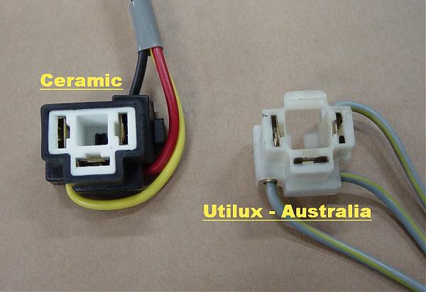

if u want normal one, go ah boy..
there got sell..
if u want high temp resistant like ceramic, u hav to find a fellow forumer nick as limbat..
Sorry to OT.. I also have the same problem.. riding rxz... any other place to get the high heat socket?

This kind of melting usually the result of poor or loose fitting - notice only the left side melted & not the whole H4 connector. The melting is only on the slot that the loose connection - resulting in electrical sparking, thus melting that particular slot. Most of the time, this can be prevented by lightly greasing the connections when u change your bulb & always make sure all the connections fit tightly.
HP: 93891138 :angel:
hai... that time the connector very hard to remove from the bulb, den i use force and i spoil my bulb.
So i use the screwdriver to loosen that connector loh...

yoyo limbat...
I want the ceramic type.
how can I purchase from u? Price?
oh ya, how much does the ceremic 1 cost??
hi guys - i pm u the price already .......... cheers

Pls note - that some OE H4 connectors have a locking device - so to remove the H4 bulb - u need to depress a lock b4 the bulb can be removed. If that little pin is not press on the bulb will not be released from the holder & if u force the bulb pin will break. cheers
