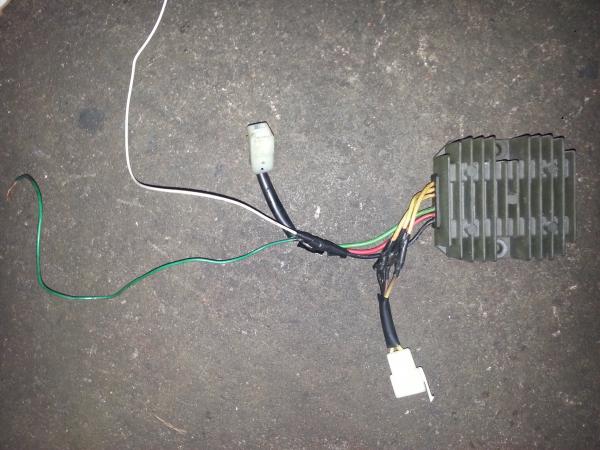

Just to check if anyone encounter this problem.
Recently I noticed the battery indicator came on while I was riding. This happened on a few occasions so I thought the battery about time liao and decided to let MS have a look. When the old battery was taken out I was quite surprise to see a sticker indicating 23/02/13 (10mth) which I thought was too soon. How long does your battery last btw?
Anyway got it replaced but after one week(yesterday) while riding the battery indicator came on again. Can't be battery issue but what could it be? Should I just ignore it?
Went MS few days back..this time replaced the 'electric fire'. Money spent. Hope this solve the issue.
Pardon me but wat is electric fire ha?
Sent from my SM-N9005 using Tapatalk
Haha honestly I got no idea. Was told the previous owner used modified hence not sending enough power to the battery... Anyway here's how it looks like.
[ATTACH=CONFIG]295773[/ATTACH]
Isnt dis a rectifier? U mean ex owner use a diff rectifier dat cause the problem? If dats de case yr problem shd b solve bah...
Lol! I think The mechanic is saying rectifier not electric-fire;) don't know why MS change to that rectifier previously. Hopefully no problem liao.
I tot u say previous owner modified?
Anyway if got problem go down n look for them since its newly changed..
The mechanic remember my bike previous owner was a lady and he fixed the rectifier for her. So far so good. No problem liao :)
Sent from my GT-I9305 using Tapatalk
Hmm...i see...
