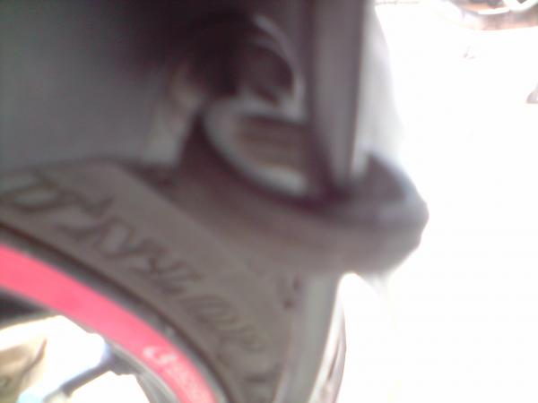

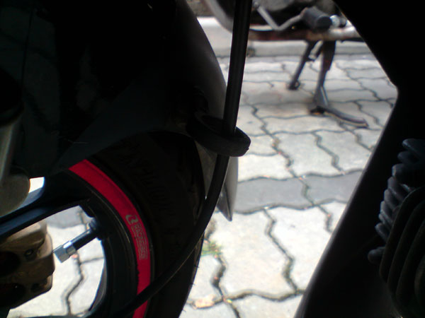

do not need to remove wheel when changing the mudguard
see pic
http://images02.olx.com.ph/ui/1/65/49/6575649_1.jpg
http://images04.olx.com.ph/ui/1/01/35/3959635_1.jpg
if needed to remove the wheels
just remove the wheel and use back the plastic holder for the speedo lines or take the speedo line out and slot it thru.
take note...
do not depress the front brakes after the wheel are out.
put the speedo line "cup" sit nicly into the hub.
check the speedo working by turning the wheel before you tighten the wheels.

the brake hose are attached to the fork lah...thats what i see in the pictures.

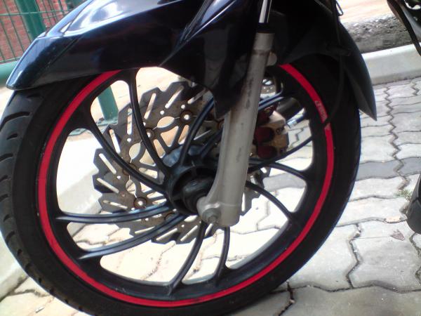

this is how my front wheel look like. there's this rubber thing attached to my mudguard. How do i go around and take it off?
that is the speedo line! not your so call brake line......:slapforehead:
when you loosen the rims and put out the bolt,the speedo " cap" will come out.just unscrew it from the cup and you can take out
TAKE NOTE
do not depress the fronts brakes as once you press you need to go re-bleed the lines.
there is 2 "teeth" @ the speedo cup holder.pls place it into the rims correctly.
