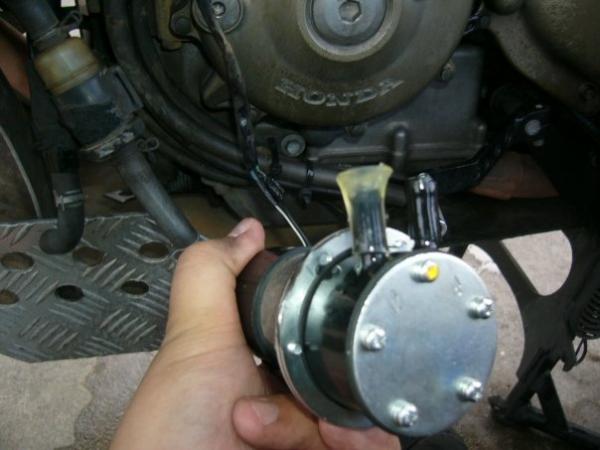

As you all know the aftermarket fuel pump inlet and outlet nozzle is a bit smaller than the oem. So we had to insert a rubber tube onto the nozzle so as to fit our fuel tubing. The mechanic inserted some kind of fish tank tube instead of the black colour tube. The fish tank rubber insert melt due to the uncompatible material to petrol. Fuel cannot be supplied to the carburator due to the choked tubing..... thanks to sambora come to my rescue bringing me a spare fuel pump. On with my journey....
After my trip from penang, went down to motoworld and give the mechanic some tongue lashing and demand that he redo my fuel pump and i personnaly supervise him doing it.
Always use those 125cc fuel tube which is smaller, then fit to the original tube which is bigger and a clip to secure it. Arrrr....this guys got no knowledge of science ar!!!???
