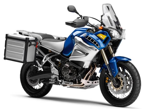

yamaha tenere 1200 released yesterday at dubai bike show :)
"Opinions are like assholes. Everyone has one. It doesn't mean its wrong or right."
sweeeeeeeeeeeeeeeeeeeeeee.....
