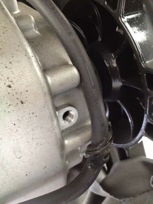

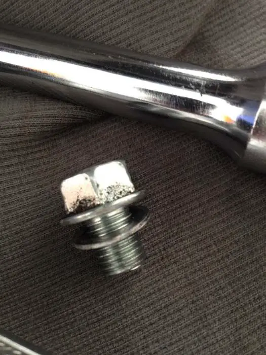

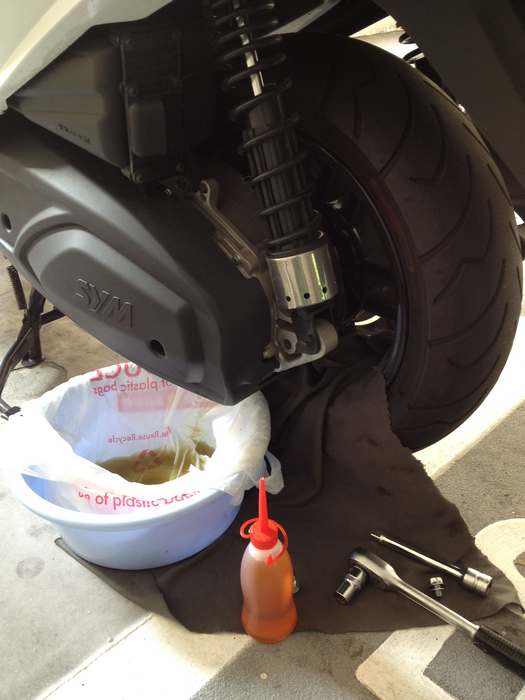

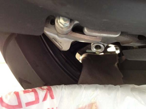

Just change gear oil to Red line 75W-140, to be honest, don't feel a difference when riding, but things i do discover are: 1) the 75W-140 gear oil is much thicker than 70w-90 castrol gear oil which used by Mah for their servicing. 2) The amount of gear oil drain out from my transmission is only200 mlo_O , i think Mah's technician don't even know the correct amount of oil to be use. 3) The transmission compartment is really ****ing hot, o_O , so it is better to use a XW-140 than a XW-90 4) both drain and top up bolt are size 14mm and with directional washer
Did u put to side stand? To drain out the last bit?
Anyway well done!
