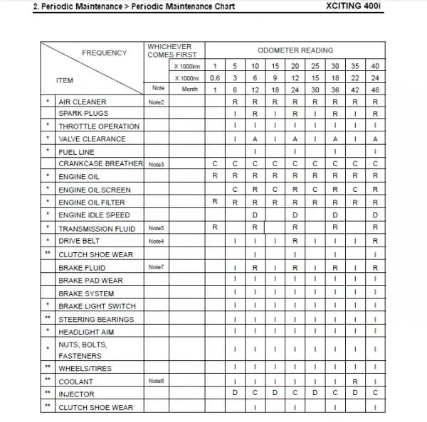

i: Inspect and clean, adjust, lubricate or replace if necessary
c: Clean
a: Adjust
r: Replace
l: Lubricate
i: Inspection
d: Diagnose
Edited by J@n
Dr.Pulley / Spy / Cardo / Garmin-Zumo / Agility City 16" / Xciting 400i ABS
'Kymco Tourclub Holland'
and Diagnose
Inspect, Replace, Clean, Adjust. I think.

do you replace your drive belt at 20K?
Can't advise u as my bike is still new. It'll be a very long time before I hit 20k. ;)
Sent from my GT-I9506 using Tapatalk
Which model? If it's the old grand dink I think better replace early. If it's the good quality ones for dt300i and x citing I think can replace later, so far mine is at 22k and still going alright.
