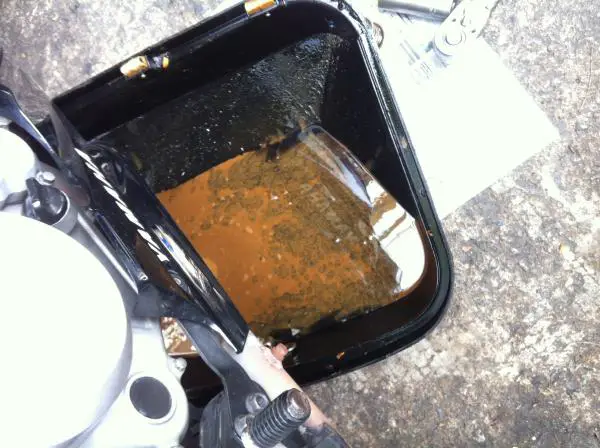

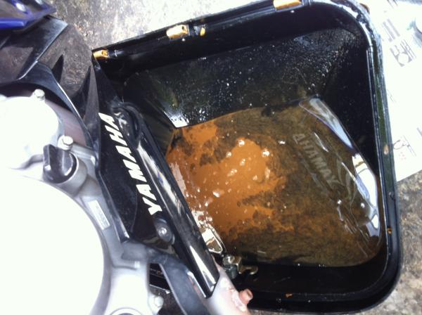

If your bike engine is water cooled, could be leaking cylinder head gasket... check coolant level....

Coolant in your engine oil.
Go to shop. And repair.
Dont ride already unless shop super close.
Dragstar 400 classic & Zx6r
Can be fixed... but could be costly.... relatively....

You bought your bike new or 2nd hand? If 2nd hand could means previous mechanic did a poor job in engine overhaul.
I never like do overhaul to an engine.
so can it be fix or my engine is soon going to RIP?
I think about $1k.... engine need to overhaul and radiator prob needs to be replaced too. That's if there isn't too much damage to the engine...
Sorry bro...
