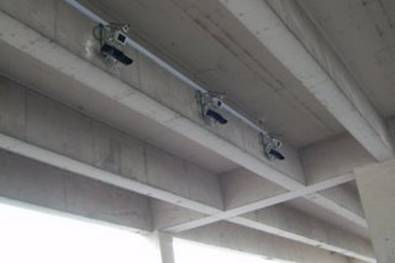

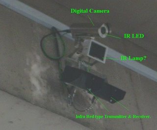

Just for you guys the info
Permanent SPEED TRAPS - LOCATIONS in Malaysian Highways.
