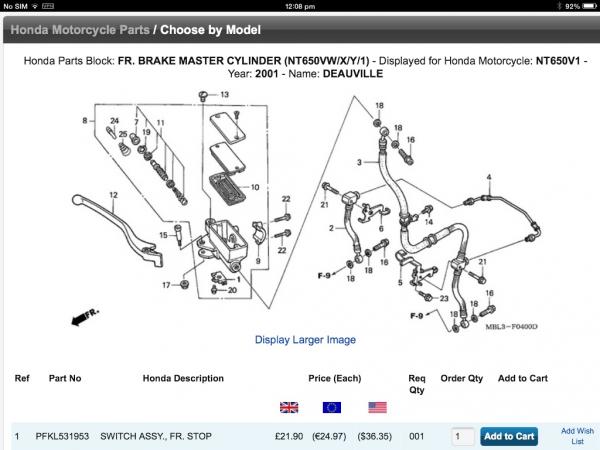

[ATTACH=CONFIG]308981[/ATTACH]

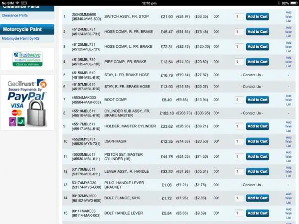

[ATTACH=CONFIG]308982[/ATTACH]
Hi Stwb, part 11 wd be your search item? Part number included for your happy hunting. Cheers
Many thanks for all the info oxygenbank & desmokat....
Yup ah chong agree cranky guy lol but he a very experienced mechanic!!! so far he always 'rescue' me from any problems i encounter... his standard sentence nw.. .Scrap the bike lah...hahahaha.
My money is always on him if not Kim Keat Motor or Republic Motor :) but I always open for options keke...
Caliper wise i noe is 2 piston front 1 rear..
Only the front master cylinder bore stroke elude me..lol nonetheless, still find the stock rather grippy even wif 'faulty' pump kit. maybe change steel braided hoses & service all calipers to maximise the as my calipers kinda jam (had a hard time rolling my wheels when bike on main stand; front rotors abit warp)
Sadly all these dun fall under warranty as i gotten the bike from a bike shop. nonetheless will try my luck lol. also my rear top cylinder is slightly leaking. so i presume just change the top gasket will suffice??

Master Cylinder Pump Kit (Brembo)
