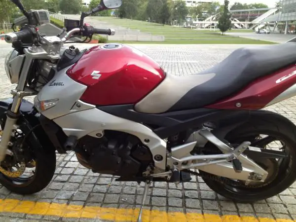

Hi guys,
Any good suggestions on how to do up my GSR? was thinking of changing its color. or even adding a box. (where can i get the box installed?)
I find it hard to find pics of GSR online. =)
thanks!

Depends on what you want first. Maybe you might want to list down what you want to be done to the bike.
Spray works should set you back under $500 (If not wrong). Go for the reputable places to avoid disappointments.
As for box, what brand / model you are looking at? There are a few vendors in Singapore doing it. Range from $100+ to $1000+. Depends on your desire of top or even side boxes.
* Suzuki GSR750
hey, i am still in the brainstorming phase. open to ideas. I need an overall idea for my project 1st. But can't seem to find nice gsr400/600 pics around (as compared to S4).
i am most probably gg for top box at the moment.
hahahaha, i am troubled over how to do up my GSR. any advises/ pictures to start me off??
