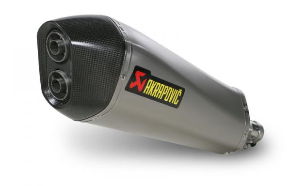

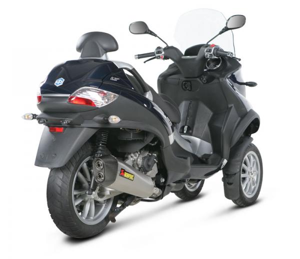

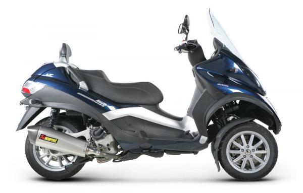

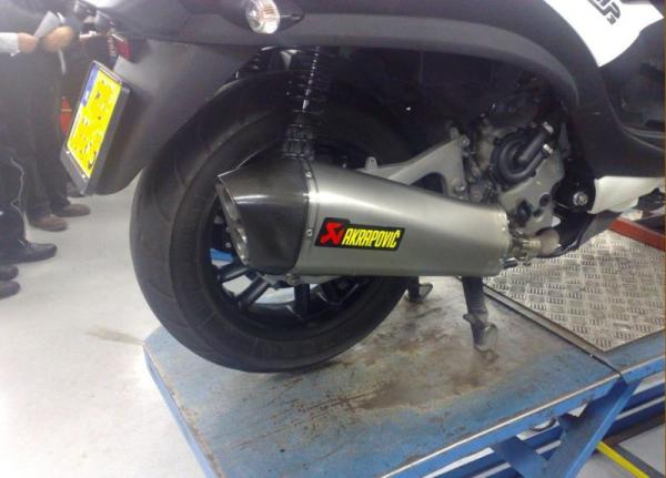

[ATTACH=CONFIG]195511[/ATTACH][ATTACH=CONFIG]195510[/ATTACH][ATTACH=CONFIG]195509[/ATTACH][ATTACH=CONFIG]195508[/ATTACH]
Akrapovic Exhaust System for MP3 400..
wondering whether it will fit Fuoco.. lol
dats nice.. fuoco system and mp3 is same right? dats means we can hav it? lol
Guest chaochao
Wa! Poisoning us with sound system and pipes!!!! :lovestruck: "ModernVespa" already posted a Akra sys for Fuoco! Urggh!!! If Akra would have developed it earlier, I'd not have gone for LV!
