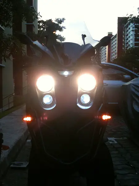

was feeling boring today and hands itchy, so decided to do another DIY on my ride.
both headlight on mod.
fuoco will only hav either low beam or highbeam on if u switch either 1 ( unless u press passing light)
wat dis mod does is when u switch to highbeam, both low and highbeam will on together.
gt dis mod from MV forum
its consumes more battery cos it now run 4x35w bulbs(0.6v more)
but i switch my highbeam bulbs to LED so its didnt affect my power cumsumption
it will act as a pole light
below pic is from MV forum
http://www.rezolutionphoto.com/photos/889996594_Qcsy5-M.jpg
wif dis connection, u cant hav only yr highbeam on.
wat i do is i did a switch so my highbeam will work as per normal.

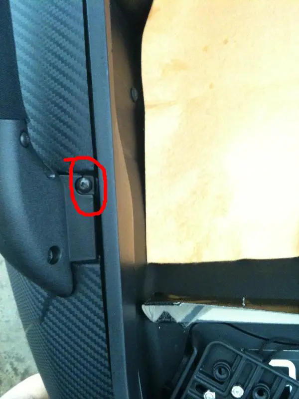

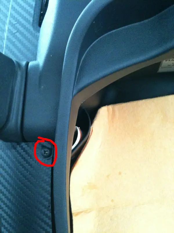

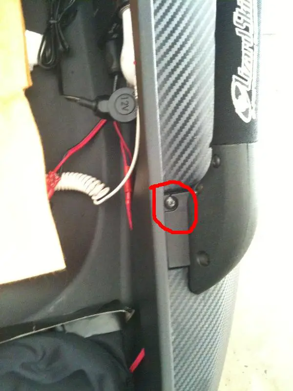

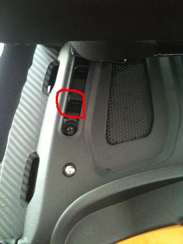

was washing my bike juz now, open my seat to found water inside (not surprise as its a known issue), so i decided to find out where it actually goes in.
to my surprise there r 4 entry place.
these r e places e water will rest and eventually goes down into e deeper compartment.
do not place any electronic stuff there (usually we juz put helmet so its ok)
i do hav a cloth at e deeper compartment to absorb e water.
lastly its a video of how it went in.

if use silicone to seal up the leaking holes, will we be able to remove the side fairing in future or will it be stuck forever?
stil can take out.. juz re-seal back again..
