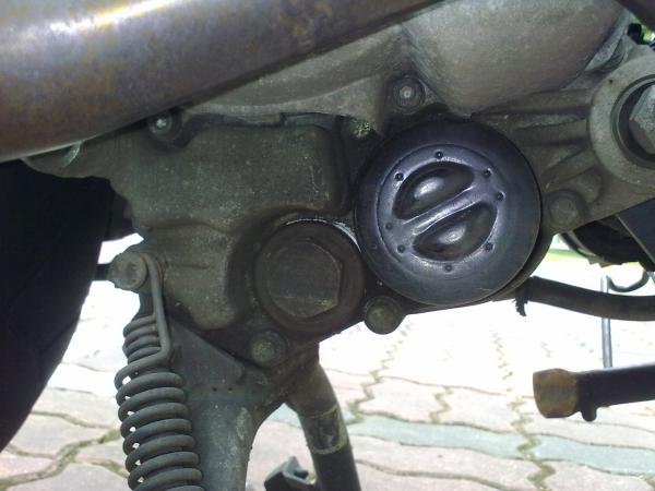

guys / gals,
can somebody tell me which is the oil drain nut??
big black thingy is the oil filter, other than that is a big ass cap screw & 2 other small screws nearer the bottom..
also best if you can tell me what size spanner will be used
many thanks for all the help rendered :)
