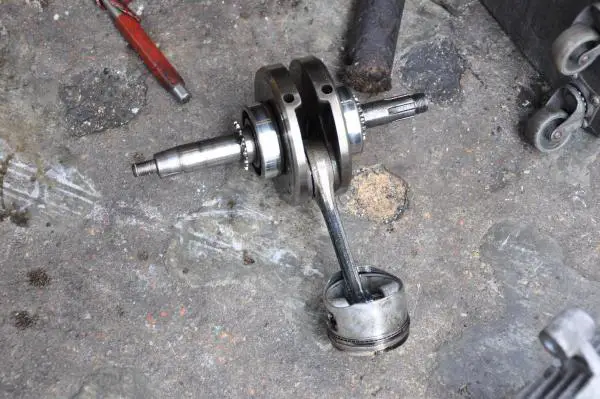

hi all,
didn't know thi thread still quite alive. it has been about 1.5 year since i bought this bike brand new. hell of a bike, bad control, bad drivability. But nice and cool to ride on! ^^
i have been doing lots of mod on it need this Feb till now, i am still improving it. hope my sharing will help the brothers here to improve its drivability.
Mod done Feb 2009:
1. Change carb to a big sized 38mm (fuel comsumption when up alot)
2. Big bore of engine on its original sleeve to 150cc.
3. Down size the original sprocket from 46t to 42t.

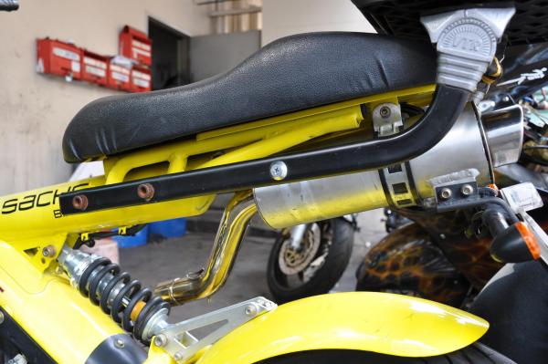

4. Operated tail muff straight through to achieve max out flow.
5. Air intake direct without any filter to acheive max intake.
Seriously upon doing the above mentioned, i already hit 110km/hr max, and remove the bad vibration. drivability improve slightly, still i am not satisfy, thus:
Mod done Sep 2009 (bike still under operation):

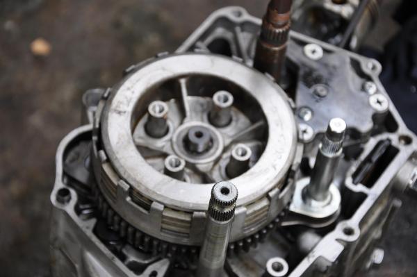

1. Improve on the gearbox by changing close ratio of 3rd & 4th gear.
2. Replace the original clutch with a performance clutch to acheive max grip.

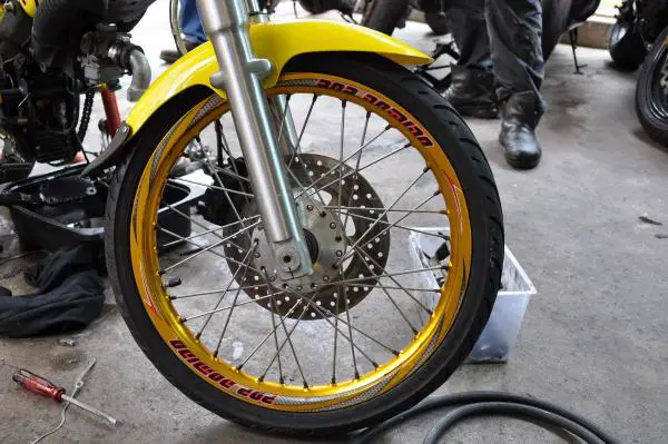

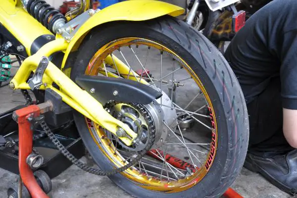

3. Replace the heavy rims with a RXK spoky allum light weight rims. (You have to sacrific the rear disc brake to a drum break after swaping the rims.
4. Further down size the sprocket from 42t to 36t. (Hope to cruise at 120km/hr.
I am really excited now and curious how this maddie will turn out to be after decided to change the gears and rims. I think its going to be really mad riding on it! haaa. i will try to post some pictures after its completely mod up. really have to thks boss JAWA at shunli industrial who willing to help me mod this maddie.

a downsized sprocket of 36T

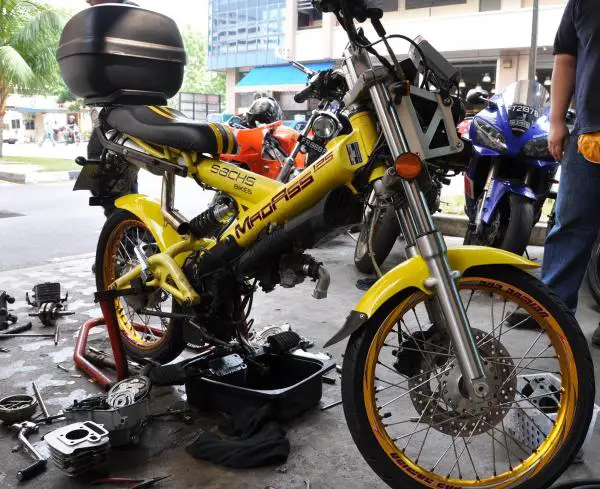

an overview of the entire maddie

wow bro seems like alot of work been done..sweet ride...wats the top speed and F/c now ? i am findin for switch..got any lobang..like ktm switch on the left and right ktm 400exc.. those nice and cute ones..

HI BRO,
i have not collected the bike yet, as the boss still tryin to match the gear ratio for me. propbably can cruise at 100km/hr, max speed 125km/hr. As for the switch quite useless to me now. As they had remove the electric start pinion starter shaft, only manual start available now.
I will update more if i collect my bike.
