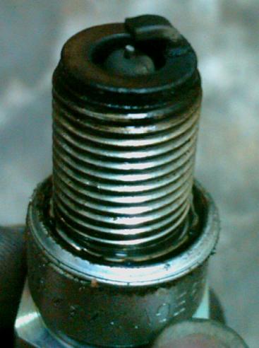

can anybody help me to read my plug?my bike cagiva mito 7th speed
plug age about 3weeks & 2500km
the electrode tip is not flat again a bit slanted (my radiator temp reach above 80'c before because of the radiator fin are blocked to much,not ok 60-65'c)
the ceramic/insulator on the other side is black
the smells is more to oil than gas.but im not really sure about this.the 2t oil setting are normal according to manual
do you all think that my plug is to hot?and possibly to rich maybe?

When was the last time you clean/replace your air filter? A dirty air filter will lead to a rich mixture too:cool:

ill look for smaller jet,but havent got time :(
