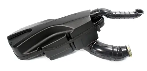

Hi guys, recently bought my bone from HQ CKA. just wanna ask, do you guys have problems riding in light or heavy rain or after rain? was told that coz my bike has k&n filter, it will have problems riding in the rain. ytd, rode out after rain stopped, after riding like 10 mins, my engine power cuts and i can't throttle above 20-30km/h. if i throttle above that, my engine stalls. any alternatives i can look into to solve this problem? senior bros, will really appreciate any advise can give me. THANKS!
Link to comment
Share on other sites
Either u use a Meiji milk bottle or 1.5L or 500ml water bottle cut into half and modified urself to use it as a cover to cover ur k & n while riding else u will forever face this issue. In-short ur carburator is drinking water and petrol at the same time.
