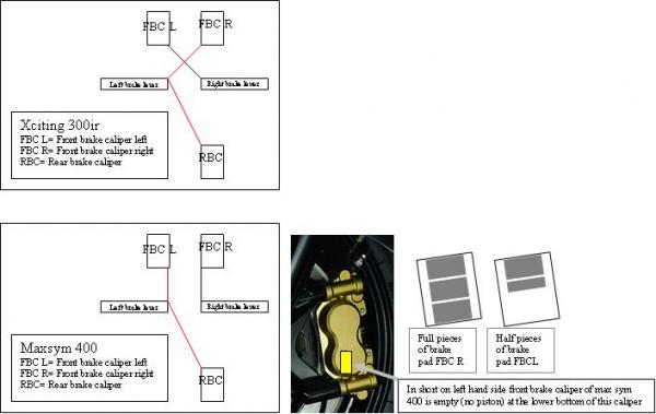

This topic is just for info and not use for any comparison!
Since the new xciting 400 will be also using radial calipers like current Maxsym 400, using front double radial calipers and with a rear brake caliper. (Can be seen from pic clearly) .
The only thing that can’t be seen till you service the front radial calipers of max sym 400, is that the FBCL is only using HALF pieces of brake pad. And the rest is full pieces of brake pad.
Me and my frens had verified this on his maxsym400!
I am looking forward on this radial calipers on xciting 400, and the advantage is changing brake pad is so easy (need not remove the whole brake caliper). Just hoping the new xciting 400 will not be doing the same thing (half brake pad).

Sorry. I too noob on this liao. I don't get a single thing just looking at the diagram.
But I believe, as a manufacturer, they'll want to pass on the convenience from technologies to the mechanics and consumer. Not having to replace a whole brake pad is a good thing IMHO!
As for DT having only single front disk brakes, I thought that's only for the DT125i.... I didn't look at the DT300i.... Haha.
Then again, these scooters aren't going in excess of 150kph most of the time, so good brakes aren't necessary. Imagine if Kymco added another brake pad for the DT, that means additional manufacturing cost, and more maintenance cost as well.
Xciting is different, cos that's more of a sports-touring-scooter than the DT city-maxi-scooter =)

Huh? That is really weird. Half a pad on the left side caliper? Mind as well use only one. Maybe to cut cost and for looks. I sure change to the full pad or both caliper and pads.
To topgearalwaysrock
The diagram is showing brake lever , brake hose and brake calipers, how there are link up using brake hose front and rear.

if you really plan to change to max sym 400, btw is using half brake pad , so there is only one side have NO piston . if you wanna change to full brake pad i dun think is possible unless you can find a after market front left brake caliper that have both piston. or change all front brake caliper to after market de.
As stock front brake caliper sym had design to run on 1 piston so the lower /other side is empty and all the hole for the brake fluid is also not drill. so very mafan to just add a piston and link up all the brake fluid and O ring ..etc, my as well change the whole caliper easier ....IMO.. that what i advice my fren
Edited by eellvviinn
What I think is because of mass production. What i think maybe SYM actually wanted one side but because of the parts sharing with 600 so make standard for both. Imagine 600 want to change fork but no stock only 400 1 sided caliper mount, totally not economical at all. Further more 400 can always upgrade to 600 stuff not the other way round. Further more I think maybe cheaper to have half a piston and pads as less material used. I still think that mind as well fit a full one and let customer absorb the cost a more powerful brake is better than a just enough brake don't you think?
i dun mind paying a few hundred more for a full , proper, stronger brake...

As for 300 why 1 sided is all base on Europe market. Kymco what what Herbert says are base on demand. All is for profit not to be the fancier.
If you look carefully for the Europe 300cc popular model most have only 1 side. As for exciting European will go for the 500 so Xciting 300 offers the styling and parts just like it's name suggest of it's bigger sulbling with a smaller cc maybe for Asian market. Not that Xciting can't go fast, infect it's faster than DT300 for top speed. Xciting is a sports scooter whereas downtown are projected as a town scooter for being nippy and economical hence 1 sided caliper gives the impression that it's cheaper to maintain, duh!
For sports use though not faster in pick up but it's enough to justify that it's more performance base , at least it felt like it. Downtown should have a double fork clamp also IMO. So xiciting indeed is a sports breed having double fork clamp/full fork and double disk - good for higher speed cornering stability and aggressive stopping. Should have better braking characteristic and lesser brake fade under heavy use.
Engine may even have the option to have a bigger bore judging that it stays on the original sleeve cylinder. There should be a 300cc big bore kit somewhere. I did a search and came across a big bore kit actually is for quad kymco. For 250cc quad to 276cc something like that and with higher compression. High compression engine usually dont last long as more heat and stresses on crack and engine IMO :p
