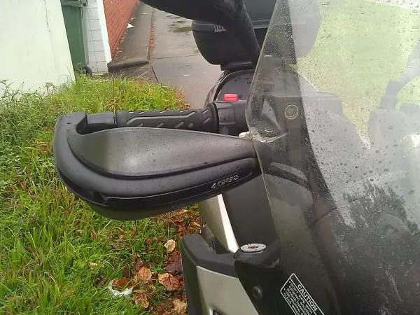

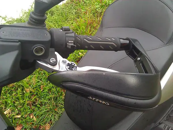

These are the pictures I've taken with my crap camera.
Bought from MotorSport, in turn, they got it from a shop in Jalan Besar. Haha.
$200, inclusive of installation.
Wah lau $200!................................................................but nice:thumb:
Actually, the hand guard makes the DT look more toot. Haha!
I just buy it to protect me hands from dirt and things that may be flung to my fingers.
I've noticed the brake lever has been scratched and oxidized a little thanks to all the small dirt, sand, leaves, twigs being flung to them.

Hmmmm...200 for that pair of handguard without led is rather pricey. Its universal type actually. Not specially for kymco. I had the similar pair with leds from hatyai.
Well, this is the kinda price I have to pay from buying from Singapore =(

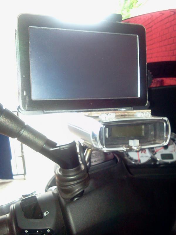

Btw guys... I found an awesome way to attach my gps..i load pics soon... Will not fly off and I am in midst of doing a waterproof cover for it too

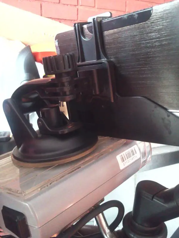

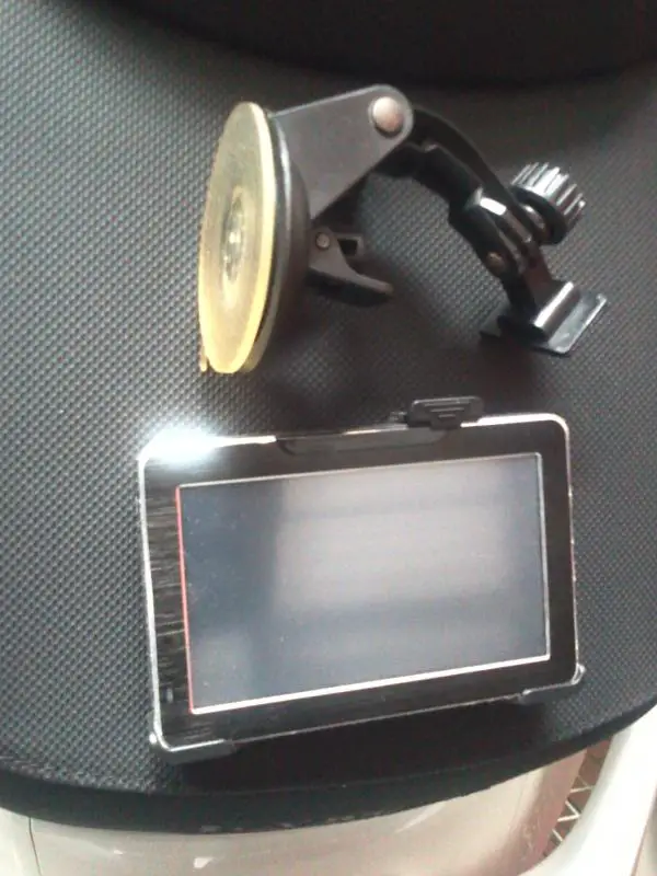

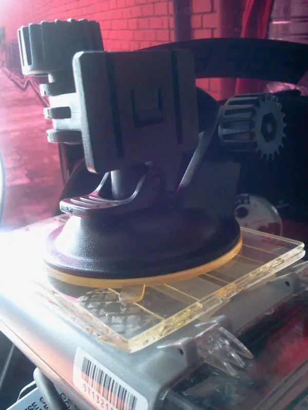

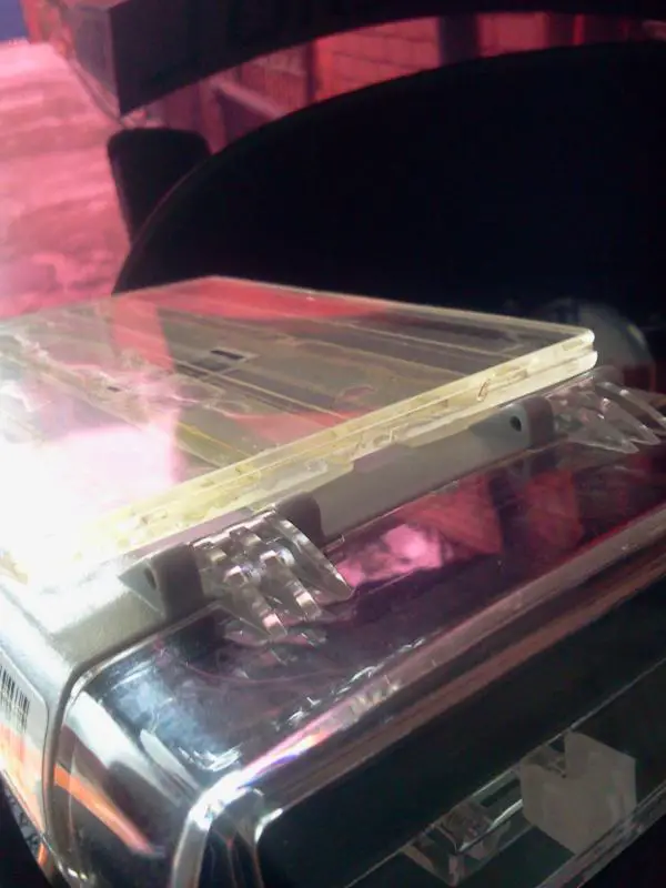

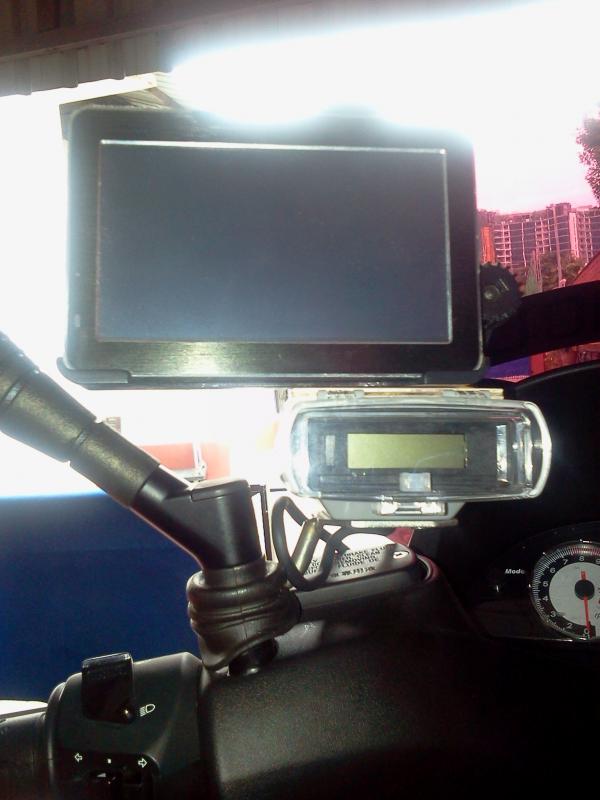

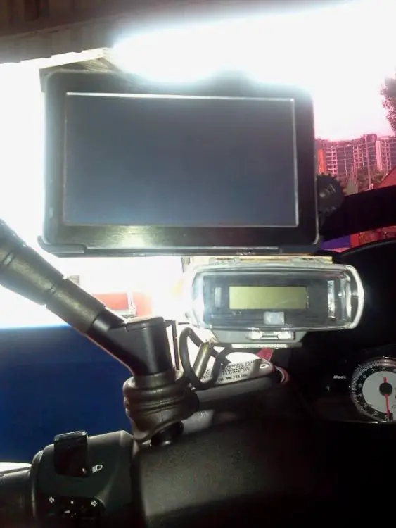

sorry guys for the bad quality of the pics..taken from my hp... ok there is one process i didnt take photos... that is the making of the acrylic base. its pretty straight forward but i will just run thru just incase coz its never too much info...
what you'll need:
scissors
paper
cardboard optional
pen
acrylic. thickness is up to you but i like to work with thinner ones for this project due to flexibility
2 long strong cable ties not too thick must be flexible
ok first i got my hands abit dirty...literally
i took a piece of paper and placed it on the top of the erp. and used my dirty hands to go along the corners of the iu.
you will see a visible mark on the paper..
cut the ouline and if possible transfer to a cardboard if u have one piece lying ard...
now this will be your template... the reason y i did it with the paper coz it will be easier to work with when getting the outline.
now to transfer to the acrylic cardboard will be easier bcoz of thickness.
cut out the outline with saw,dremel whatever u can find.. u can even use a hobby cutter cut in a few mm then use pliers to break off and sand paper.. this is the quickest way
i made 2 pieces and stuck them together for stability.
use GOOD TAPE for bonding i used 3m clear tape...sticks very well...
mounted on iu.. i stuck the acrylic piece after the hinge for the cover but its really up to u if u wanna make a whole piece thn u gotta make slots for the hinges..
Now if u think this is too much hassle.. thn just buy a piece of acrylic or go to those signboard shops in ubi or where ever and u can get it for free..but it might be some weird colour i guess? cut it to size or just leave it if u have a rectangular shape and wanna save the hassle..
but u must use decent tape la..
now i mounted in such a way that the suction tab is facing left/right i will slot 2cable ties and zip it up... just in case.. ( this step is not shown in pic.)
any questions or if u have a revised idea place let me know:) we can discuss over kopi :)
Edited by BaMBiNo
Whoa!
You actually mount the GPS on the IU!?!?
DT IU located in between the windshield, so too bad, cannot mount it on the IU.
But can try mounting on the windshield itself, like those car ones.
I know Doremi mounts the GPS on the handle bar.
