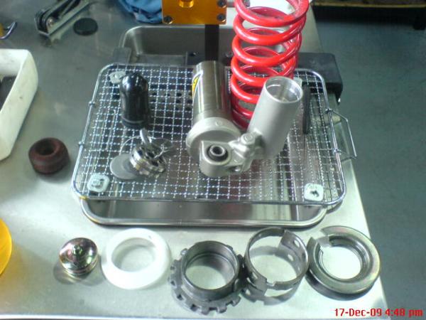

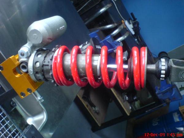

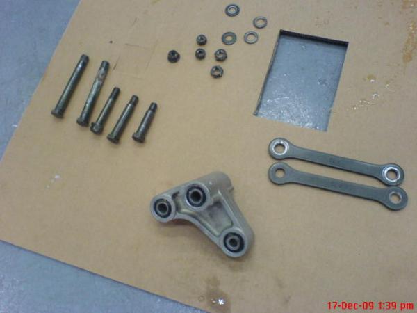

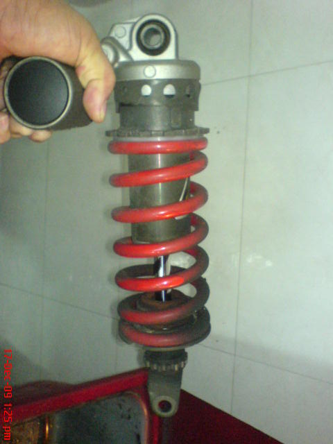

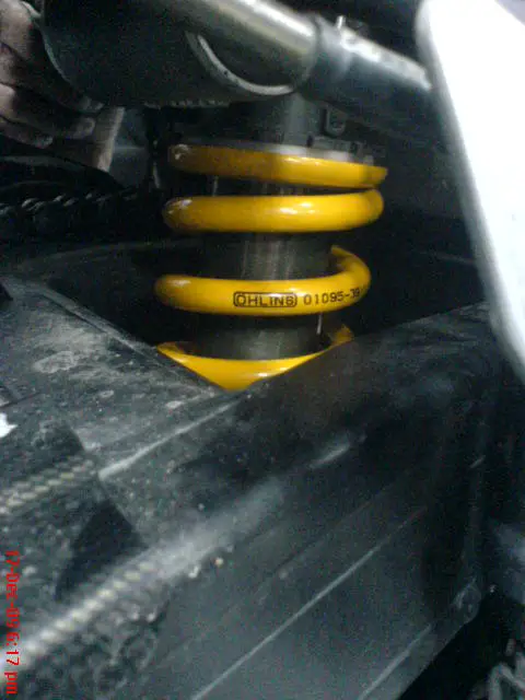

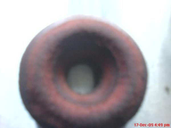

just to share with you guys what i did on my fazer 1k gen 1 recently....
last mth i did a fork servicing ( oil change plus clean up...) at sporting motors , also included a fork spring change...... using ohlins fork oil....
the improvement was significant, no more frt diving..... when initial hard throttle, no more frt wheel lift up/floating feeling.....
cost was 300 for the all, i requested to change the fork seals as well, though i reused back the dust covers
convince it was money well spent, i went back yesterday to service the rear shock, and they got a ohlins spring just nice for the gen 1( ohlins dun make springs replacement for stock shock, so i used 1 that was exactly the same as our oem shock, but stiffer spring rate)
cleaned up all the internals... and recharge nitrogen gas....
shock spring was a pleasant surprise.......
the rear shock was serviced for 180....., springs 120... total 300.
2 other o rings was changed too, that was paid separately...., they only change what is worn, nothing more......
All started from inquiring ard the limited suspension options in sg, some quoted me 2 mths waiting time for parts, some was reluctant to do, 1 "P" brand quoted me a price on PM, but another price over the phone...... dammm!!!!!!!!!!
Sporting was my last option cos they presented a race only shop, but turns out the new management realized the general biker like me also appreciated a well serviced suspension at a reasonable price......
They allowed me to be there all the way, some other shops simply told me takes 2 days..... or ask me leave bike there. i even took pics while the mech was cleaning the rear shock!!!!
fyi, the fork springs took me abt 2-3 hrs( all parts ready and bought) to be done, while shock took me half a day(bcos they had to get some seals that was worn)
i left a happy customer, there's still shops willing to do suspension for the everyday biker like me, at a reasonable price....
i dun race or need top range race products, and they didnt push me to get a race shock like some others do....
