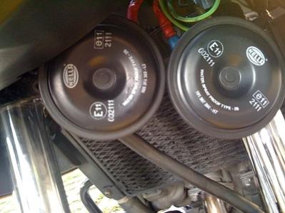

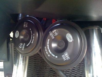

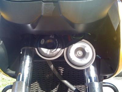

DIY Installation of the Hella Horn...
Oh man ! Its a tight squeeze...
However, still manage to squeeze in both of them, need to be stagger.
But I think this is the only horn that is small enough to squeeze in both...
Bloody loud horn... POOAARRRR...
Edited by heaven51

bro, glad u put up these pics...was wondering if those hellas would fit in the original spot...cheers!
If you're using a single piece should not be an issue unless its the supertone (red) which is huge...
Mine got from my good friend now doing a MO... Best is to install both as its classified into high and low tone...
** Note: U need to used difference bracket for mounting...
