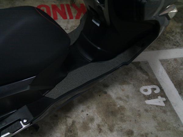

Yup, I'll be highlighting that to Roy on my upcoming servicing. But it's not a starting problem, just some abnormal noise while idling. Anyway, got something to share with you guys,
D.I.Y 3M style Mat:
How you guys think?
D.I.Y 3M style Mat:
[ATTACH=CONFIG]228606[/ATTACH]
How you guys think?

Hey Bro, how much u bought per meter and where. How u secure it?
D.I.Y 3M style Mat:
How you guys think?
nice! u bought the one for the car and cut it urself? u used screw to fix it on...
Nope, i bought those for the house(5-6 dollars for one big big piece) and fix it on with velcros straps for easy removal. Those for cars are way overpriced. =)
You can get them at those neighbourhood hardware/household shop, but you need to measure the length first becoz it's much longer than those usual sized door mat. I managed to find one really huge piece at cheap price(5-6 dollars cant remember exactly) But it's kind of thin in terms of thickness as compared to those 3M, 3A type car mat. So far never wear till got hole so still ok. Haha.
As for secure i initially wanted to use car interior/bodykits clips to hold them using back the original holes. But i find those clips too expensive and hard to find the correct size, so i just buy one long strap of velcro to use. So far it has endured the rainy season and washing session and is still holding up well.
I had this idea to replace the original ones as they gets dirty pretty easily. Hope this helps, any enquires feel free to ask me. Cheers.
