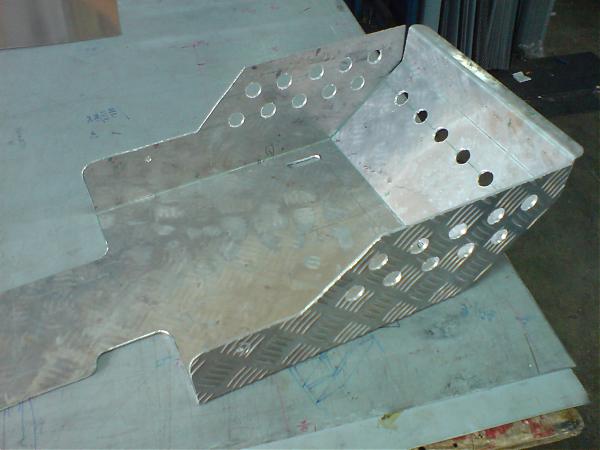

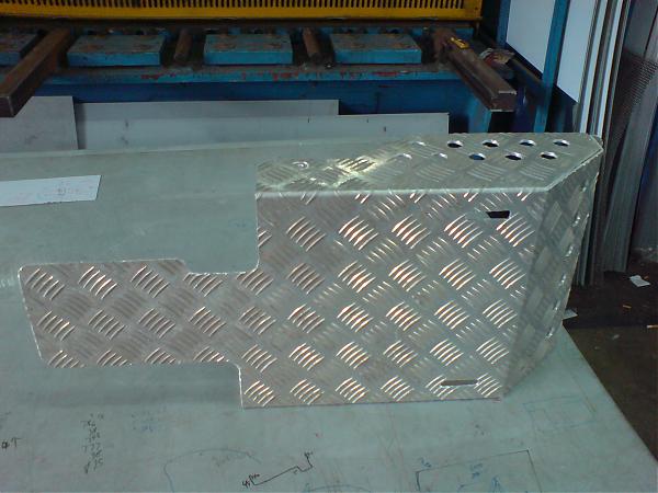

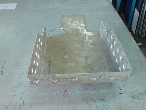

Nu7cracker>> Bro ...u checker plate undercrowl super cheow....polish it & make it outstanding...Hope u can show them this sunday trip..
