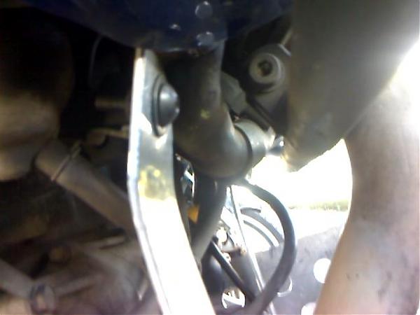

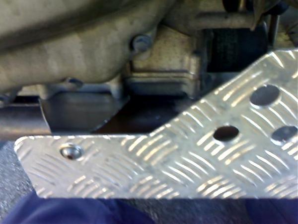

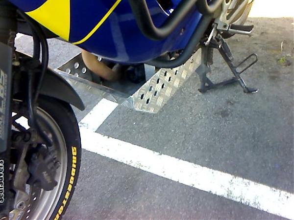

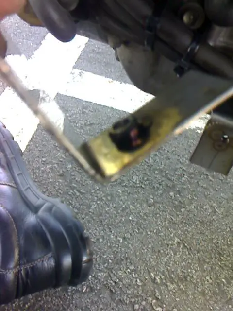

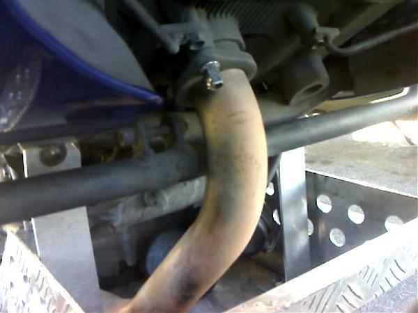

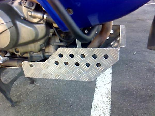

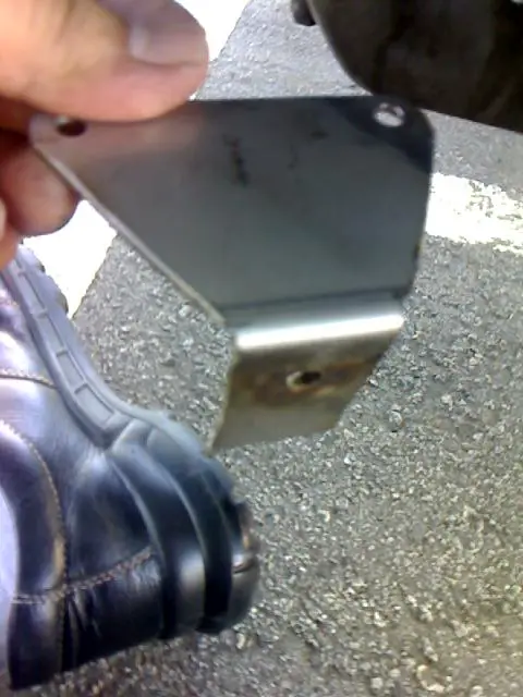

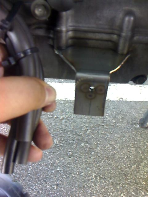

atwin>> already fabricate a new side bracket made out of stainless steel to replace the old broken one... now can say that it fits firmly and sturdy....
Nice...can fabricate for me, so that i can throw away mine...got all the welding part mark.
