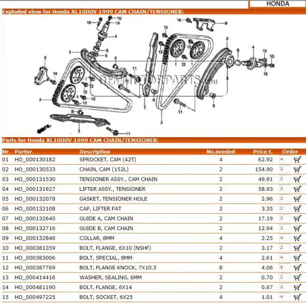

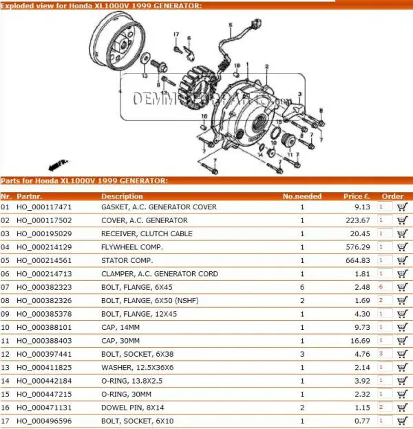

Any idea what are the stuff that u need to replace for this ? eg...do u buy all the parts or just the major one. Anyone can share what are the new parts have been replace when the bike going for overhaul
[ATTACH]142500[/ATTACH]
[ATTACH]142501[/ATTACH]
Thinking in future for overhaul of the bike ...must well buy all the stuffs from FJT & let the bike shop replace it. So that we able to know what stuff have been replaced. Is that good ?
Atwin.... maybe u wana do like what i use to do when i did Major overhaul on my 6's...
->i Told Mech to find the culprit *definately u have to noe what is wrong. but @ times, MOST of it, one leads to another so LL mush change.*
-> When its already strip, mech will call me for viewing as only he can explain why and what parts needed to change.
-> Once the new parts arrive, i will go down to workshop to Inspect the new parts Myself. Just to ensure its the correct parts...
-> before he fix the new parts.. I TOLD HIM I DEFINATELY WANT TO HAVE MY OLD PARTS BACK so he better not throw it away...
-> LASTLY.. ALWAYS SEND TO A REPUITABLE SHOP who can REALLY DO UP n UNDERSTAND OUR BIKE CATEGORY .. take me for example!!!!! knn he know all the right part but cannot INFACT he dun even know how to fix it properly..:faint::slapforehead::faint::slapforehead::faint:
i now ur 1st diagram is the timing chain and tensioner.. Both need to change especially the chain. tensioner depends... also... as we all know.. gasket is a must!!!!
2nd diagram... stator/ flywheel comp comes in a set ( 2 different thing) with its weird WIRE attach to it. new 'O' ring is a must.. best is to view item before the MECH fix it so u can have a better idea. *Thats why i always insist of viewing the new parts and differentiate with the old parts and ASK mech what is wrong with this... or that...
But i bet the sure things to have is a new piston/ring, camshaft ( hope its not that bad so can use but for milleage travelling better to change) gear bearing...n clutch plate/cluth housing..timing change/tensioner, magneto coil....startor coil.. and afew to name...
