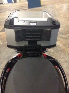

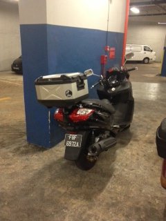

DONE!

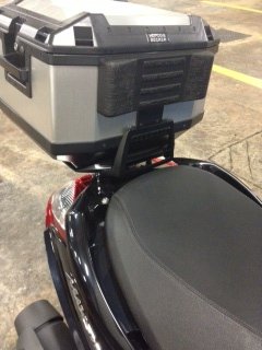

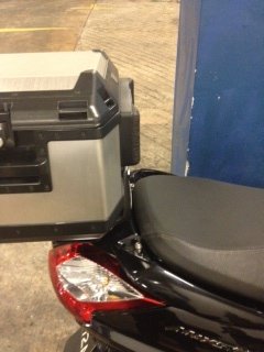

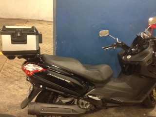

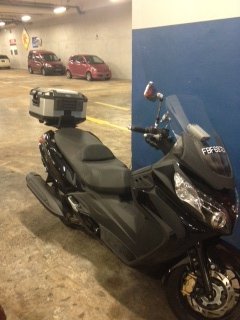

Shifted no less than 4 inch forward. Looks balanced now. No more wishy washy from the front grip and CG feels centered below my butt. The position of the box is further forward than where my previous GIVI box was. The handling is now similar to without box, except during cruising (110-120km/h) bike is more susceptible to headwinds and cross winds.

[ATTACH=CONFIG]268090[/ATTACH][ATTACH=CONFIG]268091[/ATTACH][ATTACH=CONFIG]268092[/ATTACH][ATTACH=CONFIG]268093[/ATTACH][ATTACH=CONFIG]268094[/ATTACH][ATTACH=CONFIG]268095[/ATTACH]
DONE!
Dunno why my pics kena rotated. Looks fine in my folders. Pls bear with it.
Oh by the way workmanship from Bike Fabricator is fantastic. Ah Ahn is such a Pro. He put alot of effort to measure cut file smoothed spray fix lock.
We arranged for the mod on monday for late afternoon session today, when I arrived he was hands full fixing some other stuffs. He saw me and dropped the work and attended to my bike right away. I told him I have time can wait abit he just say we had a deal to fix there and then and he will not let me wait.
Compared to the cold shoulder I got from Seng Kwang days earlier I now know where I shall return for my future projects. And oh most important part, he is cheap.

Looks good man! So they made u an entirely new rack? Hw much did it cost?
No he just modded the existing Mah's rack. Cut and additional drilling to accomodate the base plate for better weight distribution. Also redo (Welding works) the supporting pillars underside due to the trimming of the plate. Need a few installation and dismantling of rack-base plate-Box to get the desired position. screws on screws off.
Few 10s of a dollar for a first time customer for almost an hour's work. I'm Sold.
