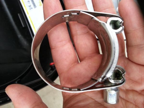

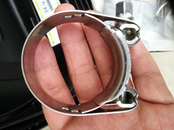

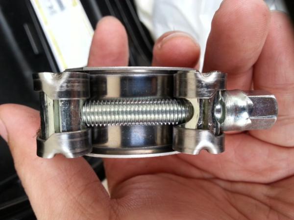

For those who are interested, i DIY and bought it at $5.20 from a hardware shop.
Thanks to those who shared the information.
It's a replacement for the poor quality and rusty exhaust clamp.
POWER! dats pretty cheap. wat did u say when u ask for the clamp? just say exhaust clamp?

Good job. This is exactly what I have.
Do be really patient removing the old one. Not the best of material. Once the bolt breaks its going to be a long day.

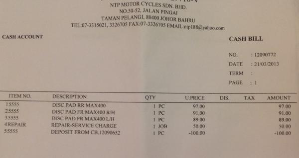

Some update on brakes.
Price quoted was exact so no issue here.
There was some uncertainty in the replacement of rear brakes probably due a newer
mechanism but front two brakes was much easier to install.
In and out about one and half hour.
Hope the info is useful.
Also my run is abt 7000km. Front left brakes is almost done however front right and rear have a lot of life left.
Just to clarify..
43140-L4A-300 RR.PAD ASSY 01 RM 97.40
45130-L4A-300 RH.FR.PAD ASSY 01 RM 91.60
45135-L4A-300 LH.FR.PAD ASSY 01 RM 89.10
Plus RM 50 for labour.
Total .. RM 328/2.475 = S$132.
Will update on their service skills and reliability on their pricing in due course.
I just showed him the photo, which 2992 posted i guess.
http://i249.photobucket.com/albums/gg228/mercenary_017/BusaKenji.jpg
Thanks.
I am impatient, after riding with the stuffs i bought including four longer counter sunk allen head stainless bolts and nuts for license plate.
I went and fix it on with my tools.
Can feel the heat, damn hot lol.
Bolt i had previously replaced with stainless steel.
But not the best grade, cause when i removed some threads got rusty less the head though.
To add you DO NOT NEED to remove the exhaust to remove the original clamp, unscrew the bolt all the way and pry the clamp open.
Yes totally agree.Thats the method i used
