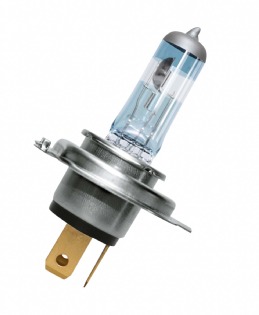

Next time i will change the light to XENON H1. Now i drive with OSRAM Night Breaker Plus.OSRAM-NIGHT-BREAKER-PLUS-H4.jpg
Not bad but Xenon will bring more light on the Street. Is also more safe.
