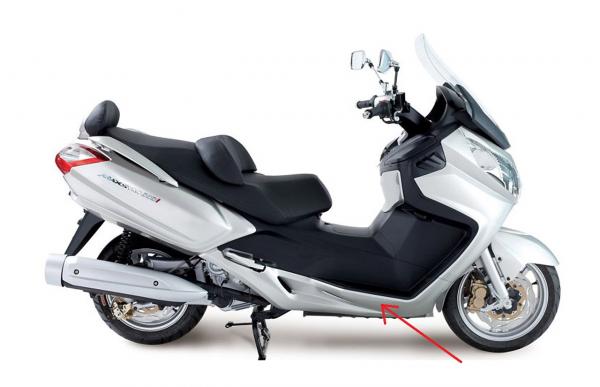

And i try to remove this part (below image) but something is holding on it.. Any ideas?
By doing so, hopefully the sparkplug is visible from here.

Hi DeZewl,
actually, u should remove the other side bottom fairing :)
The spark plug comparment is visible from there and reachable :thumb:
The bottom part, there are 4screws and 1clip bolt:
1) 1 Screw at pillion footrest
2) 2 Screws at Riders Footrest (flat ones)
3) 1 Screw at Riders Footrest (incline ones)
4) 1 clip plastic bolt infront below radiatior (just press the center part and u can take it out)
Do be careful not to force the faring and the clip plastic bolt out coz these items are fragile :)
