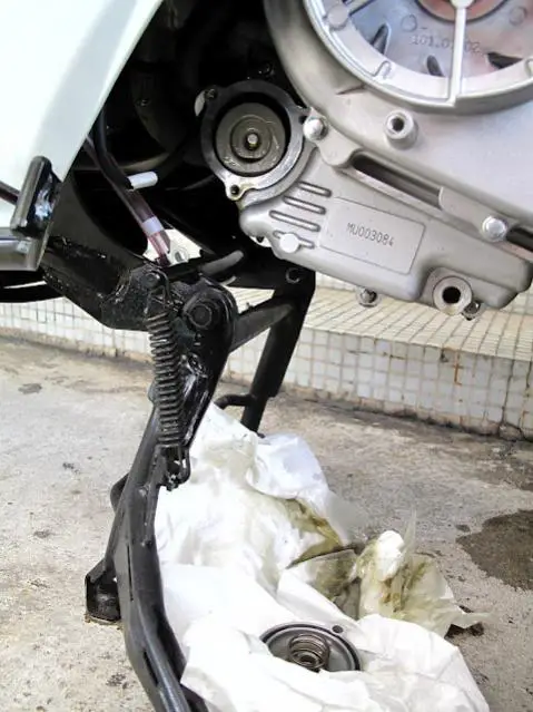

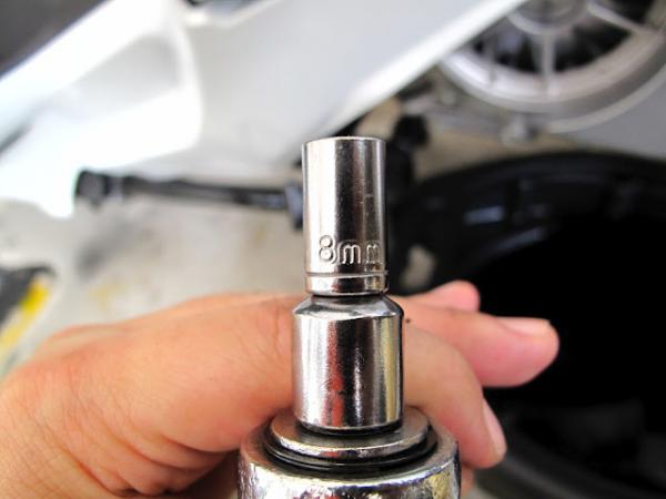

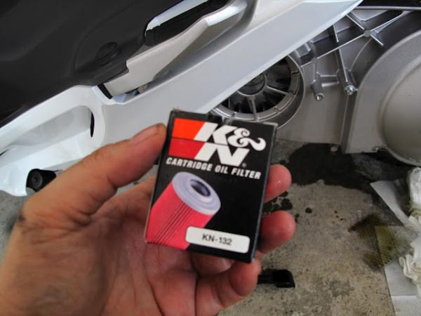

DIY change oil filter

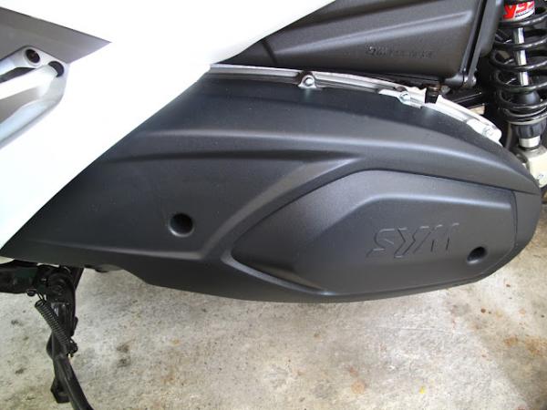

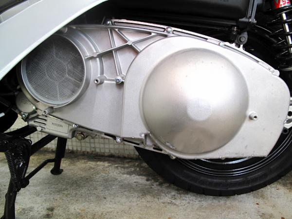

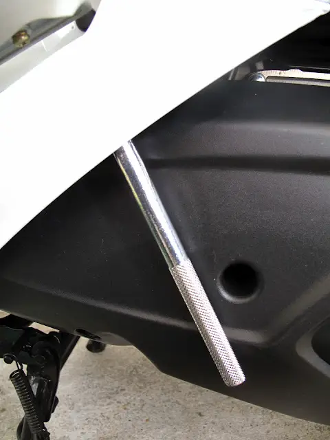

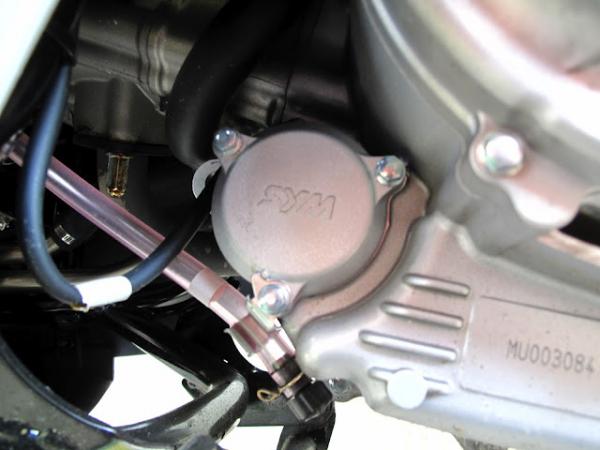

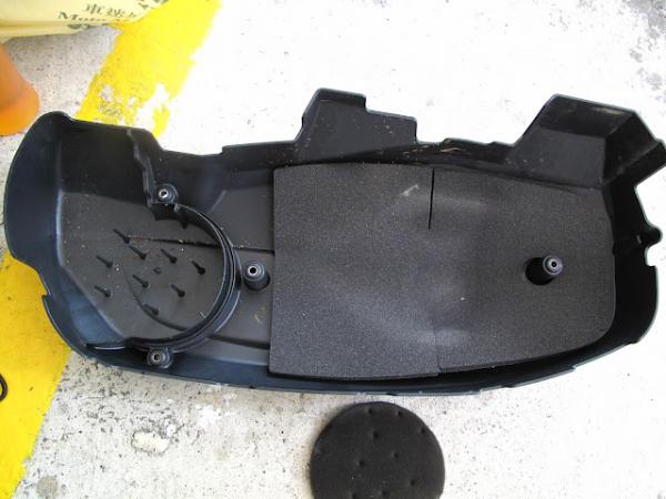

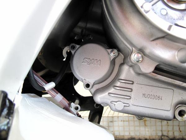

Many bro here like to DIY including me. I used to let bike shop change the oil filter because the troubleness of taking off body part to access that oil filter. Recently find out a way of doing it with out take off the bike's body part, here is how i do it.
1. The plastic cover needs to be removed, oil filter is behind

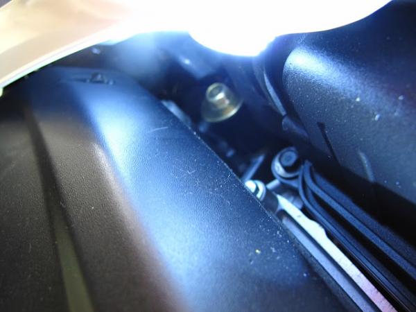

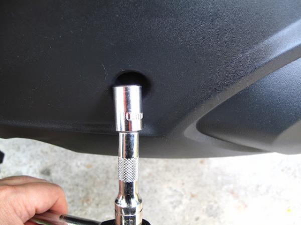

2. It was tighten by 4 of 10mm screw like this
3. The only difficult one is located at left top corner, pull the body part to open abit space that enough for spanner to squeez in
Edited by iwant1000

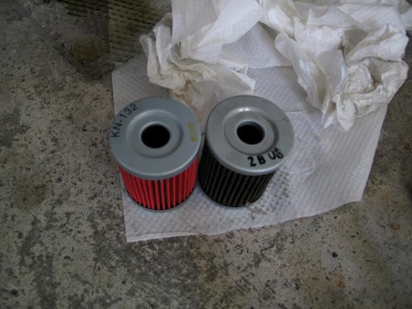

I am using a K&N 132 which is the same size with SYM stock paper oil filter, and even cheaper, S$9 get online, or bro here can buy Suzuki Burgmen 400 oil filter which is also S$9 from Chong Aik

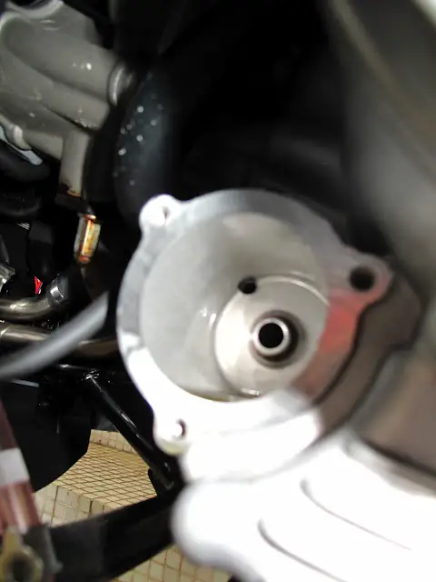

And , don't forget to check the O-ring
[ATTACH=CONFIG]247667[/ATTACH]
[ATTACH=CONFIG]247668[/ATTACH]
[ATTACH=CONFIG]247669[/ATTACH]
Hi bro, which site u go to buy K&N 132?
Great job! We can start to archive these DIY efforts, like the SW tech corner, very informative and useful.
