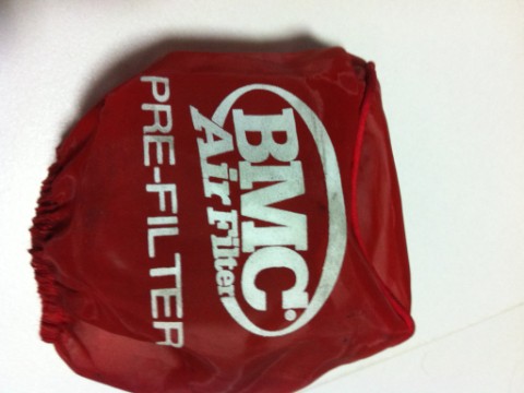

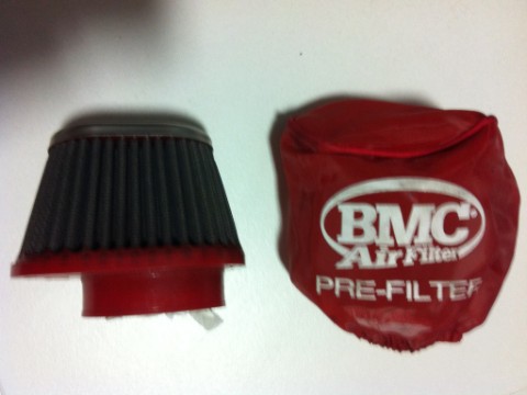

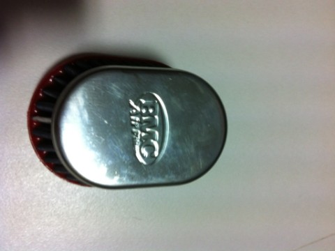

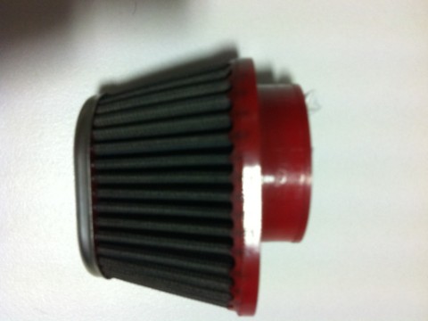

Hi guys, Wanted to sell Used BMC AIR FILTER + The Anti-Water Cover
This filter is purely use for racing and high power..
Need to find a good tuner to tune your bike with it..
Good for racing and track use
Condition : 8/10
Diameter of the hole is 5cm.. last use is using on 30mm Mikuni Carburator (TZM stock carburator)
Bought at $100 for BMC Filter and the Anti-Water cover $40
Selling Both at $100 (Filter + Cover)
Price can be slightly Nego..
Interested can sms/whatsap me at 83230202 Name: Bin
