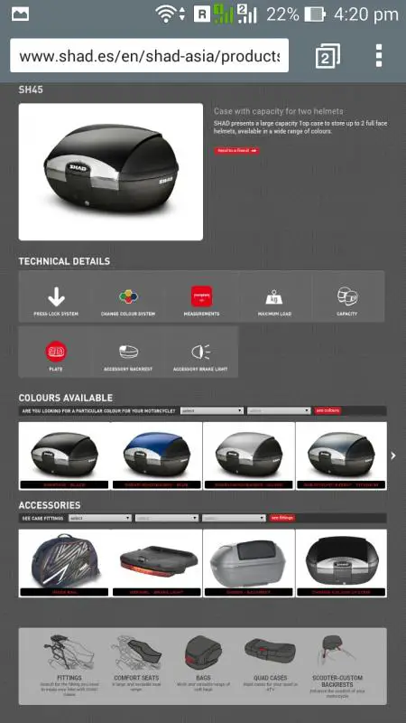

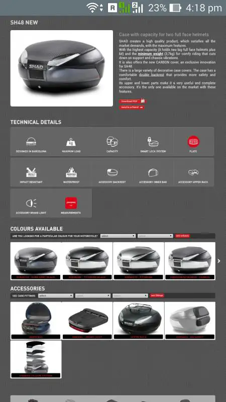

It is an inherent design fault. I kena the same. You go shad web site. They did not mention 45 is waterproof. Only 48. I sold mine and got a 48. 48 is mention as waterproof in the web site. So far so good.
One more thing with 45. The handle will be dangling unless you lock it. So during ride you dunno when the top is going to fly open.
Edited by corrado
OMG, how can like that de. If not water proof, who wants? But 48 is using different base, who would want to buy the base?
