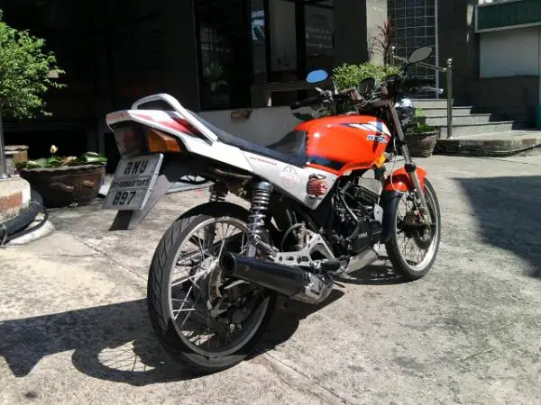

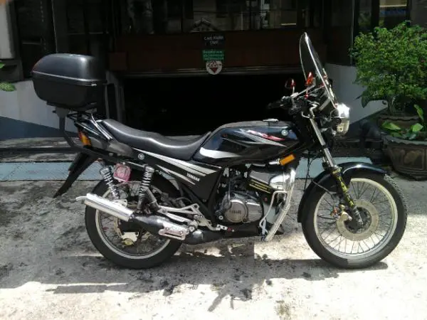

Hi.
Yes it is possible but involves a bit of work and is, as far as i know, illegal to do in Singapore.
Please see the pictures of my two RXZ. The black one (named "Bulldozer") has a rear disc set made of a VRR rear hub, oversized shaped brake disc, home-made adaptor, additional aluminium adaptor, fake "Brembo" caliper, Kawasaki brake pump on home-made bracket and modified adaptor to stock foot pedal. I bought these parts second-hand from a forum member in Singapore, it was "bolt on" as was previously used on an RXZ.
The red bike (named "Destiny") incorporates exclusively parts from Yamaha VRR, there are rear hub, disc, caliper, bracket for caliper (modified to be used upside-down), brake pump, foot pedal and footrest set (slightly nodified to fit to RXZ's frame). The only home-made part in this setup is the "arm" that takes care for the caliper not being able to rotate when braking, this uses stock RXZ's swing arm mount.
If you have ready access to VRR's parts this is the easiest way to do it - no fabrication of parts needed, just some small modifications to make the parts fit.
Braking power on both bikes is much better than with stock drum brakes, also there is no need to ever adjust the brake, however initial setup is made complicated on both due to the caliper being upside-down, very hard to bleed the brake.
Oh, and here in Thailand nobody cares for such modification, i.e. it can be considered "legal".
Kind regards.....

Hi.
Kind regards.....
Thanh
