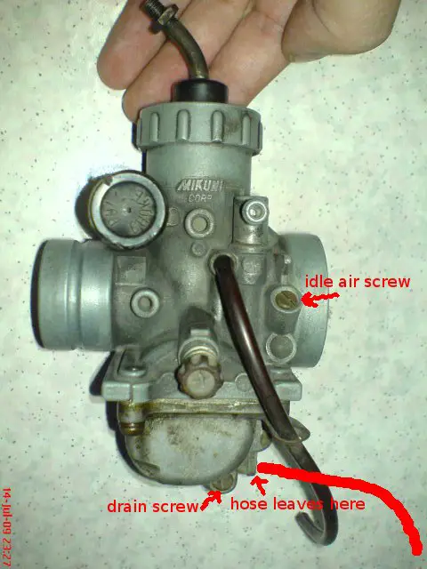

that was a lot of detail. but im pretty sure its the cap, cause the moment i check that area when it stalled, the cap was loose and when i try to pluck it into the plug, it does not seem to have a catch and wont remain tight together. (Sorry bad english)
as for the screw at the carb, the only screw i know is the idling one. i may need to check on that too.
as for the hose, is it the one where one end connects to carb, the other end is a loose one, not connected to anything?
Hi :)
Hmm i understand your English very well, no problem :) Yeah if the spark plug cap is loose you should put a new one there..... it is also important that the rubber seal on both ends of the cap are intact.
As to the screw, actually your carb has three of them, all reachable from the left side. The big one that you can turn by hand is for idle, the small one on the carb's body is for idle air mixture and the one i was talking to is on the very bottom of the carb, under the float bowl. This is a philips screw ("cross").
As for the hoses, again you will find altogether five hoses on the carb - the thick one for the petrol (left side), another thin one (left side), a thin one right side-front (2T intake) and yet another thin one right side. But the one i am talking about is the open-ended one that leaves the carb on it's rear side-bottom, near the mentioned screw.
I still had a photo of one of my carbs, sadly with that exact hose missing so i painted it in red, please have a look.

anyway, i think i know what hose is it, once, my petrol flow out from there whenever i turn on my petrol ****, and im not sure why, didnt get it to check at any mech, i just continued riding as per normal, only to off the **** whenever i park, but now its okay. you got any idea? is it cause of the overflow you were talking about in your earlier posts?
Hi.
Yes, that happens because of the overflow. Now why DOES it over flow? Normally the floater's job is to make sure exactly that does not happen.
However what often happens is that a small piece of dirt or rust gets between the floater walve needle and it's seat (that is inside the carb) and there it prevents the valve from closing properly, hence the petrol will flow out.
If the carb is old, the floater valve needle can be worn out, too (it has a rubber tip) and may need replacing. This is a small part which should be quite cheap.
Another possibility is the floater itself getting stuck, that happens some times - if the petrol flows out and you knock the outside of the float bowl with a screwdriver or something and it stops flowing, then this was the cause :) The floater can also become stuck in the "closed" position which is quite stupid - you ride off and after 100 meters or so the engine will turn off and not start again. First time this happened to me i looked everywhere except the carb..... as i found that after some pushing (due to the vibrations!) the floater became un-stuck and it all worked again.
Now, if it happens again, i just tap the outside of the carb (while still sitting on the bike) and it usually will work, but it happens rarely.

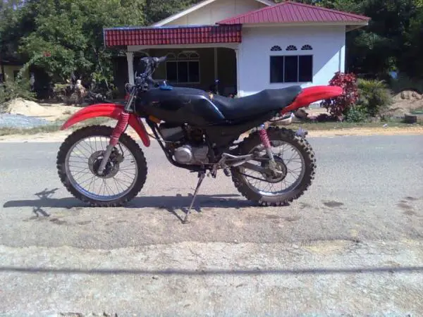

.... and also i am planning to have a third RXZ one day, that one i want to make into a scrambler type of bike (off-road). RXZ are very versatile due to their engine - that engine has a lot of torque while at the same time also able to rev high and generate a lot of horse power, specially with a little porting.... and because it lacks such "high tech" features like YPVS or similar it is very easy to work on.
Thanh
Bro!!! Ur scrambler-type-RXZ......:thumb:
