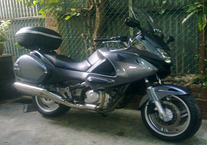

Here's another Deauville on sale:
Honda Deauville NT700
Engine capacity 680 cc
Reg date 27-12-2007
Class Class 2
Mileage 55000km
Accessories Coocase top box
Description Commuting and Touring
COE Expire Date Dec-2017
No. of owners 2
Type of vehicle Tourer
Asking price S$12000
Seller Information
Name norman
Contact No 98365885
Date Posted 29-04-2012
Good price and relatively low mileage.
I'm very tempted. Only problem is that I've just renewed my COE for another 10 years.
