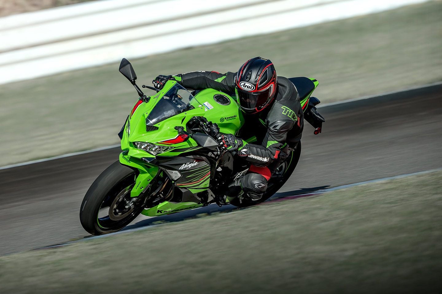

    From the nose, it’s clear that the ZX-4RR is no Ninja 400—just look at that oversized ram air duct, which feeds the airbox via intake funnels in two different lengths of 40 and 60mm. The engine’s oversquare bore allows for more valve area with 22.1mm intake and 19mm exhaust valves. Available only in KRT Edition livery, the ZX-4RR looks the Kawasaki sportbike part.Kawasaki

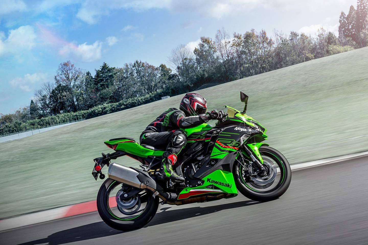

     The ZX-4RR will be a great bike for occasional trackdays.Kawasaki
