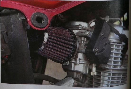

Hi bros,
I have managed to find a bigger jet for our bike. This will GREATLY improve our pickup, fc, mid range and top speed when paired with the K&N Air filter that we've purchased.
The Jet is a small customized screw that controls the flow of petrol to the carburettor. Stock jet on the pulsar 180 is size 110. recommended to use 120-125 with the k&n air filter.
When we install k&n on our pulsar, the fuel mixture runs lean. To put it simply, too much air, too little petrol. this will improve ur pickup only by a very marginal gain.
However, with the size 125 jet, it will allow more petrol to be burn with more amount of air brought in by the k&n. this will effectively bring the engine to a "richer" run, burning our petrol at a very high efficency rate, thus improving FC and greatly improving our low end and top speed.
If we were to combine the above formula with 2 denso irdium plugs, the results will be :lovestruck:
There are reports of a pulsar 180 in india with k&n and 125 jet hitting top speed of 142km/h :cheer:
